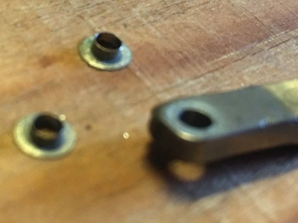

  5. Oakley Penny (X-Metal) Tune-up, Pushing the pins out: crwdns2935265:05crwdnd2935265:01crwdnd2935265:03crwdne2935265:0 Oakley Penny (X-Metal) Tune-up, Pushing the pins out: crwdns2935265:05crwdnd2935265:02crwdnd2935265:03crwdne2935265:0 Oakley Penny (X-Metal) Tune-up, Pushing the pins out: crwdns2935265:05crwdnd2935265:03crwdnd2935265:03crwdne2935265:0

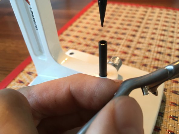

    • Hint: In case you just received your pin pusher, I recommend filing down the pushing tip slightly:
    • The idea is to increase the tip diameter so you can put less pressure on the rivets surface (less chance of deforming it), while maintaining the same force. Or in easier words, you want to distribute load: P=F/A (pressure=force over area)
    • The tool's leaflet recommends filing it down 2mm. I have not tried since it seems a bit much. I filed it from a tip diameter of 0.9mm to 1.3mm. Due to its conical shape, you don't want to lose too much pusher tip length in order to be able to still fully push the pins out (!)
    • Place the nose bridge flush on the tool's tube. Make sure pushing tip, pin and tube are in perfect alignment.
    • By turning the handle on the pin pusher, slowly push out the pin from top to bottom
    • Each pin might behave differently. Out of the four rivets (two frames) I removed, one took quite some force and came out with a small "pop". One took hard force and came out with a loud "bang". And two came out smooth as butter.

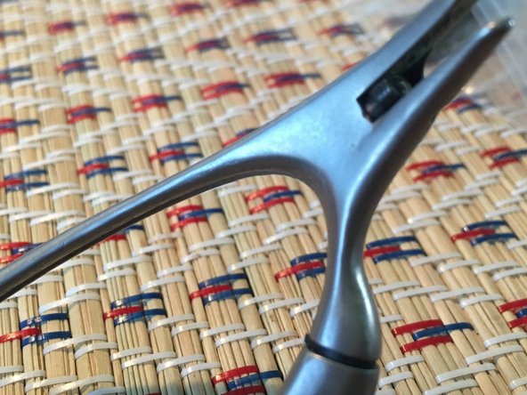

  6. Oakley Penny (X-Metal) Tune-up, Removing the flex couplers: crwdns2935265:06crwdnd2935265:01crwdnd2935265:03crwdne2935265:0 Oakley Penny (X-Metal) Tune-up, Removing the flex couplers: crwdns2935265:06crwdnd2935265:02crwdnd2935265:03crwdne2935265:0 Oakley Penny (X-Metal) Tune-up, Removing the flex couplers: crwdns2935265:06crwdnd2935265:03crwdnd2935265:03crwdne2935265:0
    • Once you got the rivets out, you can pull out the orbitals as well as the old flex couplers with tweezers

    • 2. picture: On one side of my Penny, the spring hinge assembly came out. For the curious, this is what it looks like: a spiral spring and a cam. It's easy to reinsert and if it doesn't come out by itself, leave it in. There's no need to remove it.
    • 3: Picture: Original Oakley pin and gray nose bridge rubber.

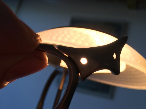

    • Add a replacement flex coupler to an orbital lug
    • Push the lug into the nose bridge and align them with a rod (or round file) of 2mm diameter. Give it a wiggle to assure the alignment
    • Use a 2mm round file to align and smoothen the pairing. Don't grind it down: you still need a press-fit for the replacement pin to stay in. But you want to give it a good cleaning and you need perfect (!) alignment to successfully re-insert the new pin.
    • See step 11 for any mistakes you can make here, before proceeding to step 10.

  11. Oakley Penny (X-Metal) Tune-up, Learn from my mistakes (!): crwdns2935265:011crwdnd2935265:01crwdnd2935265:02crwdne2935265:0 Oakley Penny (X-Metal) Tune-up, Learn from my mistakes (!): crwdns2935265:011crwdnd2935265:02crwdnd2935265:02crwdne2935265:0
    • 1. Alignment / filing: reinserting the pins takes considerably more force than getting them out. However, as always, too much is too much - the problem being, if you do it for the first time, you don't know what is too little and what is much until it's too late. I had heard this can be a problem and had ordered extra pins just in case.
    • At my very first try I didn't file the inside of the nose bridge bore much. Result: I wasn't able to push pin fully back in. I turned the frame around, pushed it back out, tried a new pin - it worked.
    • On the other orbital, I had the same problem but couldn't even get the pin back out. It had deformed so much that it was moving neither back nor forth. Pulling its end with a caliper didn't help either.
    • Wipe off the nervous sweat, place the frame in the bench vice, get a 1.5mm drill and very carefully (!) drill a hole in the pin from the front. Make sure you don't touch the walls of the nose bridge bore (2mm diameter) - you don't want to widen the press-fit. Just pretend to be a dentist. When enough material is removed, pull out the culprit.
    • Moral of the story: file, but don't grind. If the alignment isn't perfect the pin can get caught at an edge and will deform when pressure is applied.
    • 2. Grinding down the pusher tip:
    • Again, on my first try I hadn't done this enough (since I didn't know what was enough and how much is too much. 1.3mm diameter seems to work). This can result in very tiny spot marks on the back of the pin. Not bad at all but since you're at it... grind it down
    • Additionally, you can try placing cardboard between the pusher tip and the pin. Some people have gone as far as machining tips with a wide end for reinsertion.
