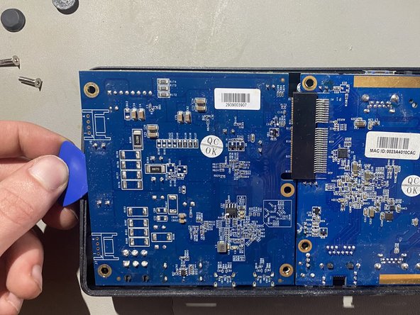

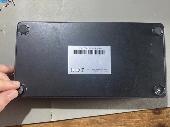

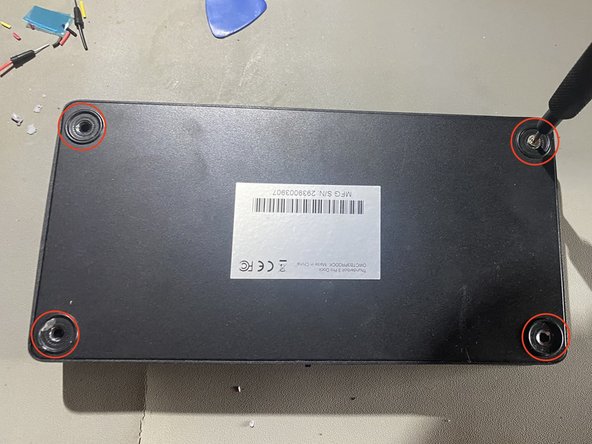

  2. OWC Thunderbolt 3 Pro Dock fan replacement, Removing bottom cover: crwdns2935265:02crwdnd2935265:01crwdnd2935265:03crwdne2935265:0 OWC Thunderbolt 3 Pro Dock fan replacement, Removing bottom cover: crwdns2935265:02crwdnd2935265:02crwdnd2935265:03crwdne2935265:0 OWC Thunderbolt 3 Pro Dock fan replacement, Removing bottom cover: crwdns2935265:02crwdnd2935265:03crwdnd2935265:03crwdne2935265:0
    • Remove the 4 rubber feet
    • Using a TORX TR8 remove the bottom 4 screws
    • Using a spudger be very gentle when prying as the mainboard is right under it.

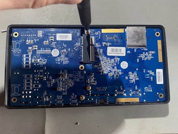

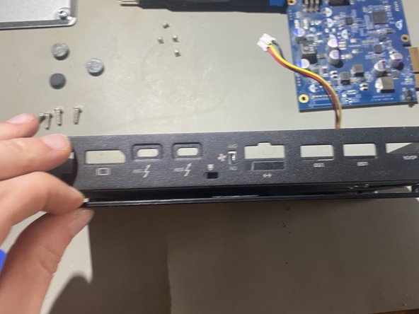

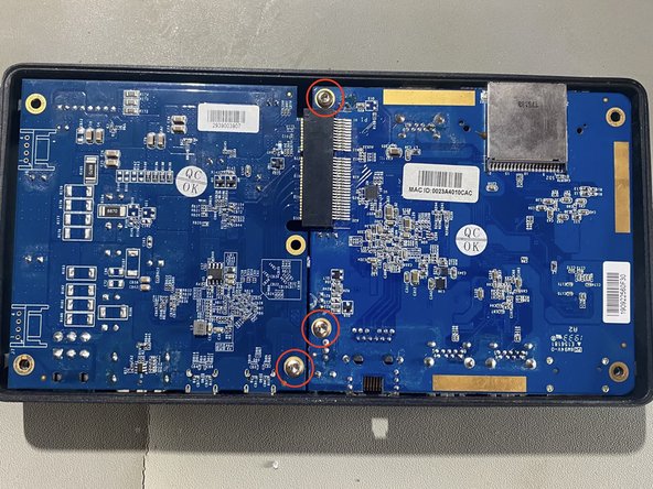

  3. OWC Thunderbolt 3 Pro Dock fan replacement, Removing the mainboard: crwdns2935265:03crwdnd2935265:01crwdnd2935265:03crwdne2935265:0 OWC Thunderbolt 3 Pro Dock fan replacement, Removing the mainboard: crwdns2935265:03crwdnd2935265:02crwdnd2935265:03crwdne2935265:0 OWC Thunderbolt 3 Pro Dock fan replacement, Removing the mainboard: crwdns2935265:03crwdnd2935265:03crwdnd2935265:03crwdne2935265:0
    • Using a TORX TR8 remove the three screws holding in the mainboard
    • Using a plastic spudger gently shift the mainboard out of the chassis, make sure that all the front I/O is clear and isnt caught as it sits flush to the back.
    • Make sure to disconnect the fan from the back so the mainboard can be removed.

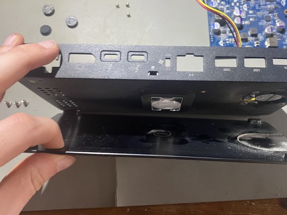

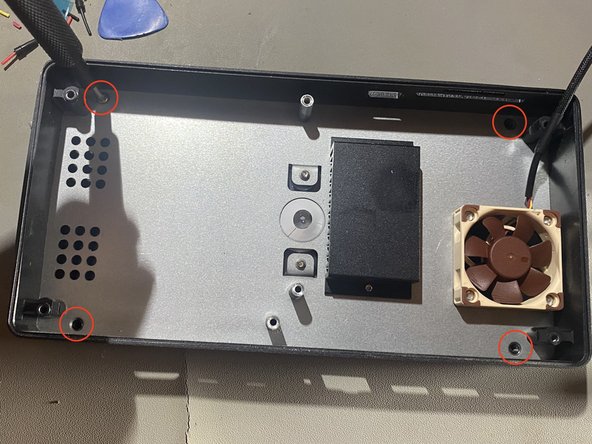

  4. OWC Thunderbolt 3 Pro Dock fan replacement, Removing the top cover: crwdns2935265:04crwdnd2935265:01crwdnd2935265:03crwdne2935265:0 OWC Thunderbolt 3 Pro Dock fan replacement, Removing the top cover: crwdns2935265:04crwdnd2935265:02crwdnd2935265:03crwdne2935265:0 OWC Thunderbolt 3 Pro Dock fan replacement, Removing the top cover: crwdns2935265:04crwdnd2935265:03crwdnd2935265:03crwdne2935265:0
    • Using a TORX TR8 remove the four screws holding in the top cover
    • Using your fingers or a plastic spudger pry away the top cover from the main chassis, it might resist a bit as it is glued on to the top LED.

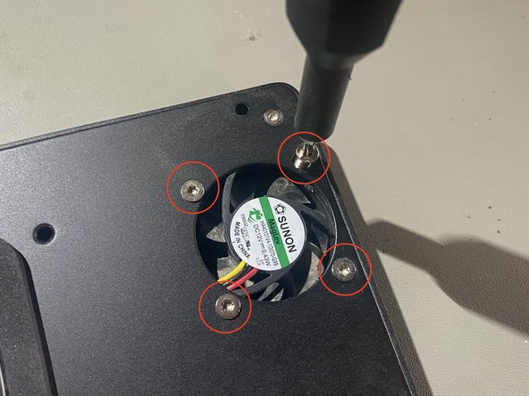

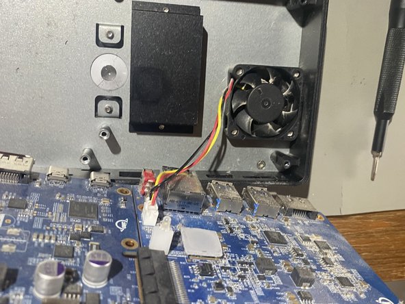

  5. OWC Thunderbolt 3 Pro Dock fan replacement, Removing the fan: crwdns2935265:05crwdnd2935265:01crwdnd2935265:03crwdne2935265:0 OWC Thunderbolt 3 Pro Dock fan replacement, Removing the fan: crwdns2935265:05crwdnd2935265:02crwdnd2935265:03crwdne2935265:0 OWC Thunderbolt 3 Pro Dock fan replacement, Removing the fan: crwdns2935265:05crwdnd2935265:03crwdnd2935265:03crwdne2935265:0

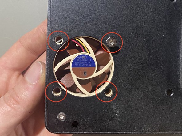

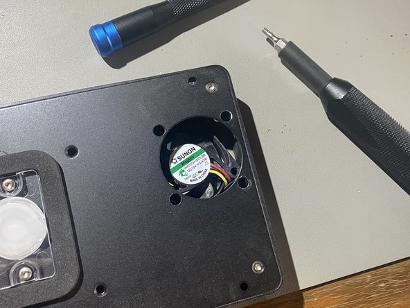

    • Using a TORX TR10 bit remove the four screws holding in the fan
    • the fan should fall out when all the screws are out

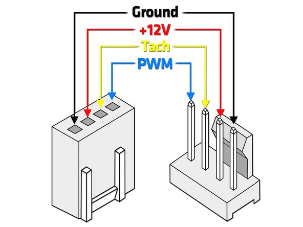

  6. OWC Thunderbolt 3 Pro Dock fan replacement, New fan: crwdns2935265:06crwdnd2935265:01crwdnd2935265:03crwdne2935265:0 OWC Thunderbolt 3 Pro Dock fan replacement, New fan: crwdns2935265:06crwdnd2935265:02crwdnd2935265:03crwdne2935265:0 OWC Thunderbolt 3 Pro Dock fan replacement, New fan: crwdns2935265:06crwdnd2935265:03crwdnd2935265:03crwdne2935265:0
    • Take your fan out of its packaging and take note of the polarity of the wires, check the second photo for a diagram.
    • Using a TORX TR10 bit and the scews you just took out screw the fan back in. Make sure of its orientation, id recommend having it as exhaust (like in the photo) so it sucks air in through the heatsink. Putting it as intake might not work as well, i would just follow how the manufacturer did it.

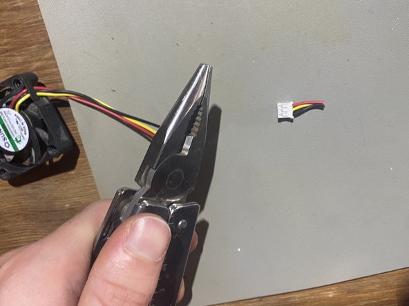

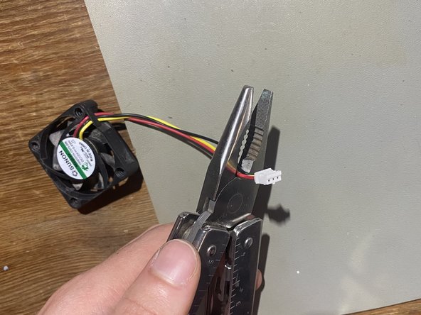

  7. OWC Thunderbolt 3 Pro Dock fan replacement, Sacrificing old fan: crwdns2935265:07crwdnd2935265:01crwdnd2935265:03crwdne2935265:0 OWC Thunderbolt 3 Pro Dock fan replacement, Sacrificing old fan: crwdns2935265:07crwdnd2935265:02crwdnd2935265:03crwdne2935265:0 OWC Thunderbolt 3 Pro Dock fan replacement, Sacrificing old fan: crwdns2935265:07crwdnd2935265:03crwdnd2935265:03crwdne2935265:0
    • First check the polarity for the wiring of the original fan. In this case: Red = 12V, Yellow = Ground, Black = Tachometer
    • Then cut off the end of the old fan, im doing this because I want to preserve the new fan in its current state and be able to use it in the future

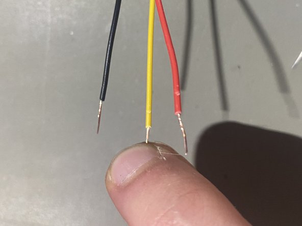

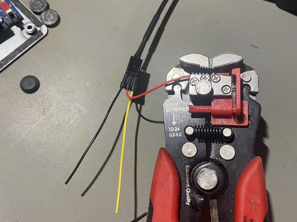

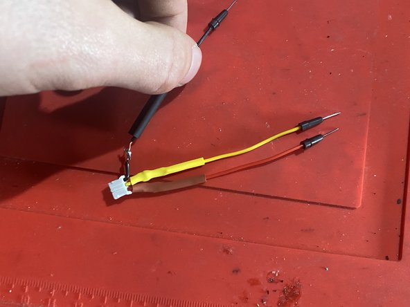

  8. OWC Thunderbolt 3 Pro Dock fan replacement, Creating new wires: crwdns2935265:08crwdnd2935265:01crwdnd2935265:03crwdne2935265:0 OWC Thunderbolt 3 Pro Dock fan replacement, Creating new wires: crwdns2935265:08crwdnd2935265:02crwdnd2935265:03crwdne2935265:0 OWC Thunderbolt 3 Pro Dock fan replacement, Creating new wires: crwdns2935265:08crwdnd2935265:03crwdnd2935265:03crwdne2935265:0
    • I used some breadboard wires as the fit snugly into the new fans headers
    • Cut off and strip the ends of the wires
    • Pro tip - twist the end of the wires so they dont become a mess

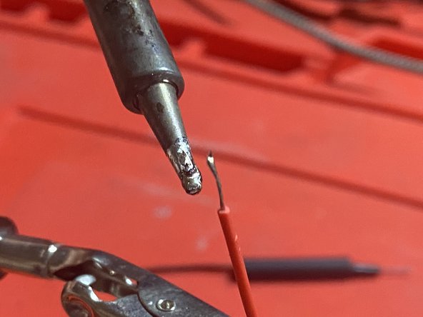

  9. OWC Thunderbolt 3 Pro Dock fan replacement, Prepping for soldering: crwdns2935265:09crwdnd2935265:01crwdnd2935265:03crwdne2935265:0 OWC Thunderbolt 3 Pro Dock fan replacement, Prepping for soldering: crwdns2935265:09crwdnd2935265:02crwdnd2935265:03crwdne2935265:0 OWC Thunderbolt 3 Pro Dock fan replacement, Prepping for soldering: crwdns2935265:09crwdnd2935265:03crwdnd2935265:03crwdne2935265:0

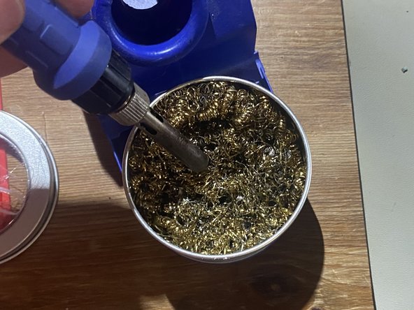

    • Warm up your soldering iron to a suitable temperature (im using unleaded solder so go a bit lower if youre using leaded, or better use unleaded)
    • Clean your tip before soldering so you have a nice tip
    • Put a bit of solder and tin the all the ends of the wires
  10. OWC Thunderbolt 3 Pro Dock fan replacement, Joining the wires: crwdns2935265:010crwdnd2935265:01crwdnd2935265:03crwdne2935265:0 OWC Thunderbolt 3 Pro Dock fan replacement, Joining the wires: crwdns2935265:010crwdnd2935265:02crwdnd2935265:03crwdne2935265:0 OWC Thunderbolt 3 Pro Dock fan replacement, Joining the wires: crwdns2935265:010crwdnd2935265:03crwdnd2935265:03crwdne2935265:0

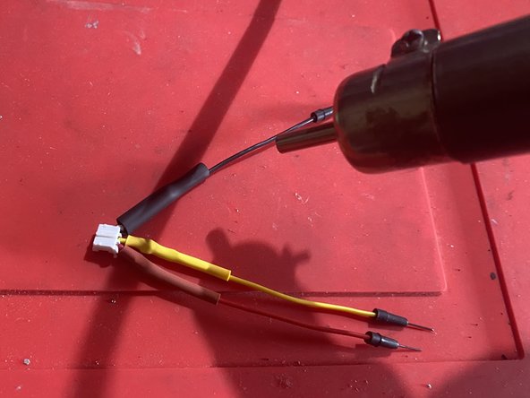

    • Line up all the wires and put on the heatshrink beforehand - a lot of people forget this
    • Solder everything together, you shoudnt need to add much solder as you already tinned both sides
    • Use a heatgun / source of heat to shrink the heatshrink and seal your work.

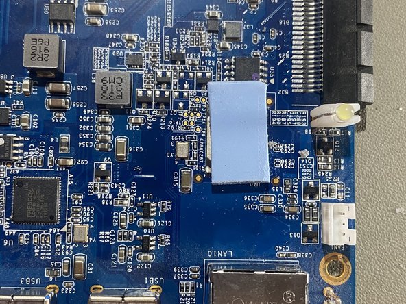

  13. OWC Thunderbolt 3 Pro Dock fan replacement, Replacing thermal pad (optional): crwdns2935265:013crwdnd2935265:01crwdnd2935265:03crwdne2935265:0 OWC Thunderbolt 3 Pro Dock fan replacement, Replacing thermal pad (optional): crwdns2935265:013crwdnd2935265:02crwdnd2935265:03crwdne2935265:0 OWC Thunderbolt 3 Pro Dock fan replacement, Replacing thermal pad (optional): crwdns2935265:013crwdnd2935265:03crwdnd2935265:03crwdne2935265:0
    • Get some 2mm thick thermal pads to swap out the old ones. The old ones measured in at 1.75mm so the closest is 2mm (round up to guarantee contact as 1.5mm would have no contact)
    • Cut the thermal pad to size and send it
