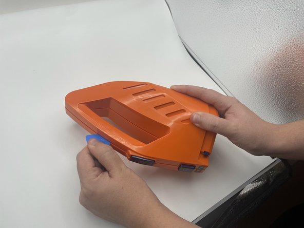

    3. ORFELD EV-660-S222 Power Button Spring Replacement: crwdns2935265:03crwdnd2935265:01crwdnd2935265:02crwdne2935265:0 ORFELD EV-660-S222 Power Button Spring Replacement: crwdns2935265:03crwdnd2935265:02crwdnd2935265:02crwdne2935265:0
      • Using tweezers, remove the sticker connecting the two halves.
      • Use the opening pick to gently separate the top half and the bottom half of the vacuum.
      • Press the blue buttons near the sides of the battery LEDs to remove the top half.

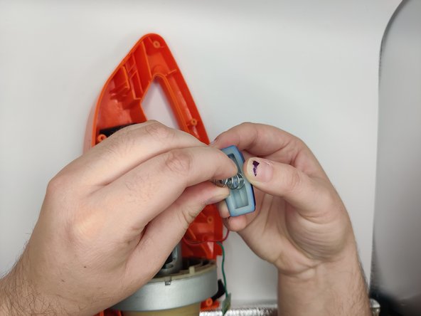

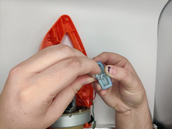

    5. ORFELD EV-660-S222 Power Button Spring Replacement: crwdns2935265:05crwdnd2935265:01crwdnd2935265:03crwdne2935265:0 ORFELD EV-660-S222 Power Button Spring Replacement: crwdns2935265:05crwdnd2935265:02crwdnd2935265:03crwdne2935265:0 ORFELD EV-660-S222 Power Button Spring Replacement: crwdns2935265:05crwdnd2935265:03crwdnd2935265:03crwdne2935265:0
      • Gently pull out the power button from the board.
      • Gently pull up and twist the old spring off of the button.
