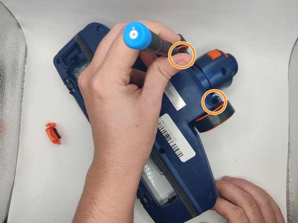

    • Place the roller attachment bottom side up so you may access the brush.
    • Apply pressure with the iFixit opening tool to the tabbed side of the orange cap to release the roller brush.

    • Remove the 11.5 mm screws surrounding the roller brush divot using a Phillips #0 screwdriver.
    • Remove the 11.5 mm screws located by the wheels using a Phillips #1 screwdriver.

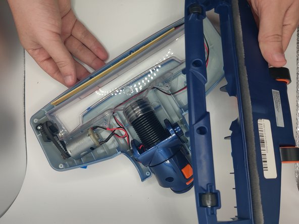

  4. ORFELD EV-660-S222 Brush Roller Attachment LED Board Replacement: crwdns2935265:04crwdnd2935265:01crwdnd2935265:02crwdne2935265:0 ORFELD EV-660-S222 Brush Roller Attachment LED Board Replacement: crwdns2935265:04crwdnd2935265:02crwdnd2935265:02crwdne2935265:0
    • Use the iFixit opening tool to pry the attachment open to pull the top free with your hands.

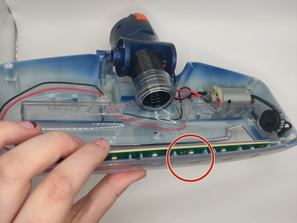

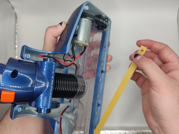

  5. ORFELD EV-660-S222 Brush Roller Attachment LED Board Replacement: crwdns2935265:05crwdnd2935265:01crwdnd2935265:03crwdne2935265:0 ORFELD EV-660-S222 Brush Roller Attachment LED Board Replacement: crwdns2935265:05crwdnd2935265:02crwdnd2935265:03crwdne2935265:0 ORFELD EV-660-S222 Brush Roller Attachment LED Board Replacement: crwdns2935265:05crwdnd2935265:03crwdnd2935265:03crwdne2935265:0
    • Pull the LED strip out with your hands or tweezers as there is a small hole at the top of the strip.

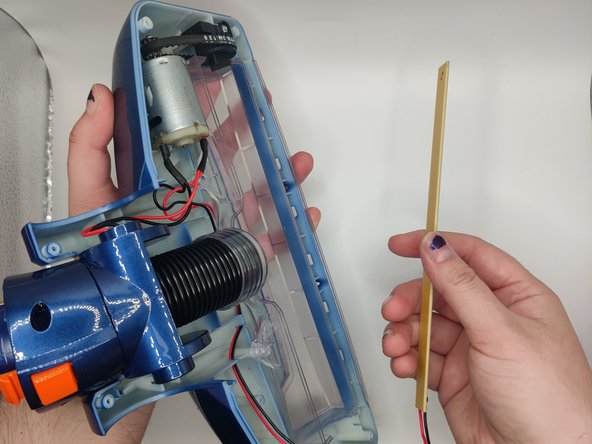

  6. ORFELD EV-660-S222 Brush Roller Attachment LED Board Replacement: crwdns2935265:06crwdnd2935265:01crwdnd2935265:01crwdne2935265:0
    • Use a soldering iron to remove the wires.
    • Please take proper precautions during soldering and hold the wires you are soldering with tweezers.
    • To solder the new board, make sure the red wire is on the LED side and the black one is on the side without LEDs.
