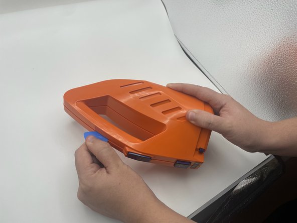

    • Separate the dust cover and the motor from the vacuum body by pressing the eject button.
  2. ORFELD EV-660-S222 Battery LED Board Replacement: crwdns2935265:02crwdnd2935265:01crwdnd2935265:02crwdne2935265:0 ORFELD EV-660-S222 Battery LED Board Replacement: crwdns2935265:02crwdnd2935265:02crwdnd2935265:02crwdne2935265:0
    • Place the vacuum on its side, with the screws facing towards you.
    • Remove the 11.5 mm screws using a Phillips #1 screwdriver.
  3. ORFELD EV-660-S222 Battery LED Board Replacement: crwdns2935265:03crwdnd2935265:01crwdnd2935265:02crwdne2935265:0 ORFELD EV-660-S222 Battery LED Board Replacement: crwdns2935265:03crwdnd2935265:02crwdnd2935265:02crwdne2935265:0
    • Using tweezers, remove the sticker connecting the two halves.
    • Use the opening pick to gently separate the top half and the bottom half of the vacuum.
    • Press the blue buttons near the sides of the battery LEDs to remove the top half.

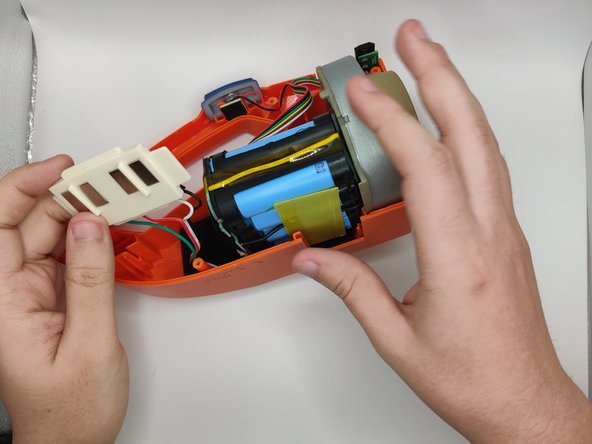

  4. ORFELD EV-660-S222 Battery LED Board Replacement: crwdns2935265:04crwdnd2935265:01crwdnd2935265:02crwdne2935265:0 ORFELD EV-660-S222 Battery LED Board Replacement: crwdns2935265:04crwdnd2935265:02crwdnd2935265:02crwdne2935265:0
    • Slide out the charging port.
  5. ORFELD EV-660-S222 Battery LED Board Replacement: crwdns2935265:05crwdnd2935265:01crwdnd2935265:01crwdne2935265:0
    • Lift the battery slightly to reveal the pin connectors.
    • Gently disconnect the six-pin connector that connects to the power button and battery LEDs.

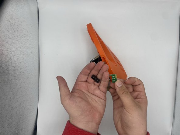

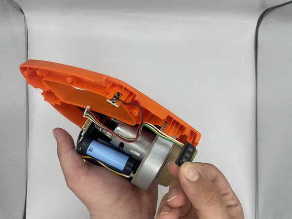

  6. ORFELD EV-660-S222 Battery LED Board Replacement: crwdns2935265:06crwdnd2935265:01crwdnd2935265:03crwdne2935265:0 ORFELD EV-660-S222 Battery LED Board Replacement: crwdns2935265:06crwdnd2935265:02crwdnd2935265:03crwdne2935265:0 ORFELD EV-660-S222 Battery LED Board Replacement: crwdns2935265:06crwdnd2935265:03crwdnd2935265:03crwdne2935265:0
    • Slide out the battery LEDs from the compartment.
    • Remove the plastic LED cover from the LED board.
  7. ORFELD EV-660-S222 Battery LED Board Replacement: crwdns2935265:07crwdnd2935265:01crwdnd2935265:01crwdne2935265:0
    • Desolder the LED board from the wires.
