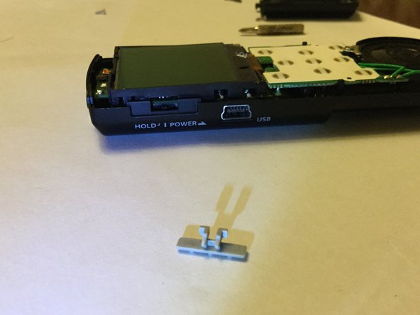

    • The screws loosen the front cover, but due to its simplicity you can do it at any angle you want.
    • Take off the power switch before you loose it.
    • I still don't know what the screw on the speaker is for, but I will keep it on anyway.

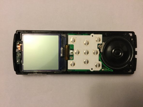

  4. OLYMPUS VN-8100PC Disassembly: crwdns2935265:04crwdnd2935265:01crwdnd2935265:02crwdne2935265:0 OLYMPUS VN-8100PC Disassembly: crwdns2935265:04crwdnd2935265:02crwdnd2935265:02crwdne2935265:0
    • If you guys are talking about iPhones, then this one is extremely simple.
    • Still, have to watch your six. Here, it is the video cable. Go ahead, undetatch the screen.
    • You can flip the screen over to the keyboard side. It make everything easier and will not damage anything.

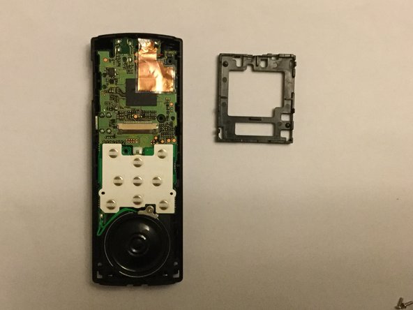

    • Then is the plastic scaffolding. I met a tiny little amount of double sided tape in my device, but getting it off is simple task, just use your common sense on this.
    • Go ahead, get this screw off.
  5. OLYMPUS VN-8100PC Disassembly: crwdns2935265:05crwdnd2935265:01crwdnd2935265:03crwdne2935265:0 OLYMPUS VN-8100PC Disassembly: crwdns2935265:05crwdnd2935265:02crwdnd2935265:03crwdne2935265:0 OLYMPUS VN-8100PC Disassembly: crwdns2935265:05crwdnd2935265:03crwdnd2935265:03crwdne2935265:0

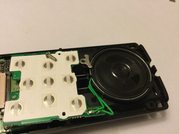

    • Next is the two silicon chips. The keyboard have a connector on the top right corner, so watch out.
    • The four proms for battery is soldered in place, and two run beneath the speaker. So, have to get this thing off.
    • Just pull on the metal tab inbeded in the pile of foam-like foam, and then oull the speaker out. With it, comes out the keyboard.

    • Now, pop off the motherboard. There are three ports that hold it down, but avoid them is simple. Very simple, actually.
    • Do anyone know what those copper foil serve? They are soldered to the board so I didn't dare removing it. And, there is nothing interesting beneath...
