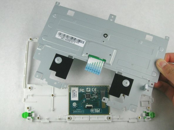

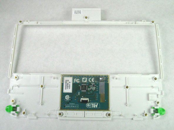

  19. OLPC XO-4 Touch Touchpad Controller Replacement, Touchpad Controller: crwdns2935265:019crwdnd2935265:01crwdnd2935265:01crwdne2935265:0
    • Remove the two 4mm Phillips screws that attach the metal plate to the touchpad assembly.
    • Be sure not to lose the silver magnet in the lower right corner of the touchpad assembly.
  20. OLPC XO-4 Touch Touchpad Controller Replacement: crwdns2935265:020crwdnd2935265:01crwdnd2935265:03crwdne2935265:0 OLPC XO-4 Touch Touchpad Controller Replacement: crwdns2935265:020crwdnd2935265:02crwdnd2935265:03crwdne2935265:0 OLPC XO-4 Touch Touchpad Controller Replacement: crwdns2935265:020crwdnd2935265:03crwdnd2935265:03crwdne2935265:0
    • Remove the silver contact tape from the metal plate.
    • Lift the metal plate off of the touchpad assembly.
