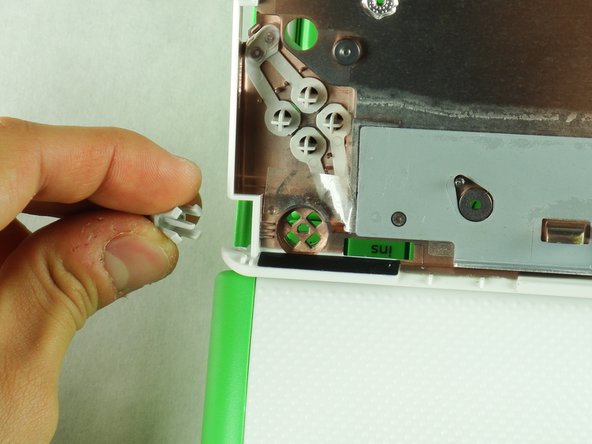

  21. OLPC XO-4 Touch Power Button Replacement, Power Button: crwdns2935265:021crwdnd2935265:01crwdnd2935265:02crwdne2935265:0 OLPC XO-4 Touch Power Button Replacement, Power Button: crwdns2935265:021crwdnd2935265:02crwdnd2935265:02crwdne2935265:0
    • Remove the power button by pinching in the four tabs until the power button can be pushed out.
