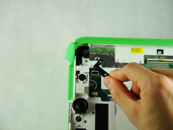

    3. OLPC XO-4 Touch Antenna Replacement: crwdns2935265:016crwdnd2935265:01crwdnd2935265:02crwdne2935265:0 OLPC XO-4 Touch Antenna Replacement: crwdns2935265:016crwdnd2935265:02crwdnd2935265:02crwdne2935265:0
      • Flip the top part of the laptop over so that you are looking at the front.
      • Unscrew the two 12.7mm Phillips #1 screws on each antenna ear clamp.
      • Remove the two outer clamps.
    4. OLPC XO-4 Touch Antenna Replacement: crwdns2935265:017crwdnd2935265:01crwdnd2935265:03crwdne2935265:0 OLPC XO-4 Touch Antenna Replacement: crwdns2935265:017crwdnd2935265:02crwdnd2935265:03crwdne2935265:0 OLPC XO-4 Touch Antenna Replacement: crwdns2935265:017crwdnd2935265:03crwdnd2935265:03crwdne2935265:0
      • Remove the antenna wires from the black tabs.
      • On the front side of the laptop, carefully pull the wire through the hole and out.
      • Remove the antenna from the laptop.
