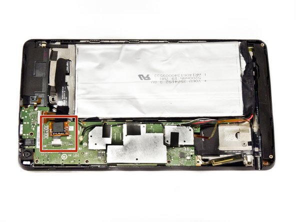

      • Peel away the tape covering the top right side of the motherboard. The plastic opening tools are useful in nudging the tape off.
      • Make sure you are using your anti-static wrist strap.
    2. Nvidia Shield Tablet Touchscreen Controller Replacement: crwdns2935265:05crwdnd2935265:01crwdnd2935265:02crwdne2935265:0 Nvidia Shield Tablet Touchscreen Controller Replacement: crwdns2935265:05crwdnd2935265:02crwdnd2935265:02crwdne2935265:0
      • Using the precision tweezers, gently remove the touchscreen controller from its port.

how to change this controller ???? he is not removable !!! where to buy it?
Tom - crwdns2934203:0crwdne2934203:0 crwdns2950251:0crwdne2950251:0
How are you supposed to replace this part if it's connected to the Touchscreen panel by a flat ribbon cable. The pictures show the touchscreen controller that has been severed/cut by where the flat cable goes 90 degrees towards the touchscreen, you cannot just replace this part by itself as shown in the pictures. WTF????
Luis Nido - crwdns2934203:0crwdne2934203:0 crwdns2950251:0crwdne2950251:0
My Thoughts exactly. Mine has one connector that is easily removed, the smaller end. The large wide end is up under a metal frame. I gave a gentle tug, but apparently its glued or sealed. Now to figure out how to remove it. Guessing a heat gun to the glass is the easiest way? No coming apart from the back/inside!
The Watson - crwdns2934203:0crwdne2934203:0 crwdns2950251:0crwdne2950251:0
why is this still up. you can’t replace this part so the title is misleading. This part is torn easy you must remove the board from the tablet with the touch cable connector unlatched but the cable still in. if you try to bull it out first it rips.
