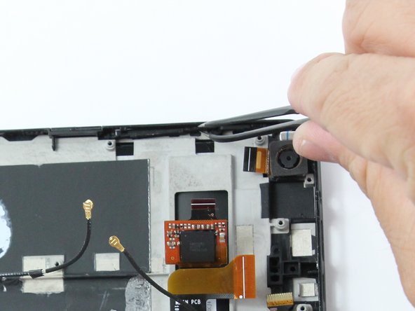

      • Using your tweezers, lightly lift around the edges to lift the motherboard.
      • When lifting the motherboard around the edge near the rear facing camera, there is a copper cable that is connected underneath the motherboard.
      • Before lifting the motherboard out, use your tweezers to disconnect rear camera's copper cable from the motherboard.
    5. Nvidia Shield Tablet K1 Volume Control Button Replacement: crwdns2935265:020crwdnd2935265:01crwdnd2935265:02crwdne2935265:0 Nvidia Shield Tablet K1 Volume Control Button Replacement: crwdns2935265:020crwdnd2935265:02crwdnd2935265:02crwdne2935265:0
      • Use a soldering iron to desolder the Micro USB Port from the motherboard.
      • Now the Micro USB Port is free from the motherboard.
