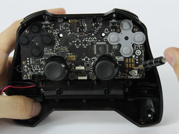

  5. Nvidia Shield TV 1st Generation Controller Battery Replacement: crwdns2935265:05crwdnd2935265:01crwdnd2935265:03crwdne2935265:0 Nvidia Shield TV 1st Generation Controller Battery Replacement: crwdns2935265:05crwdnd2935265:02crwdnd2935265:03crwdne2935265:0 Nvidia Shield TV 1st Generation Controller Battery Replacement: crwdns2935265:05crwdnd2935265:03crwdnd2935265:03crwdne2935265:0
    • Using the T6 Torx screwdriver, remove the indicated eight screws from the logic board.
    • Lift the logic board away from the front case.

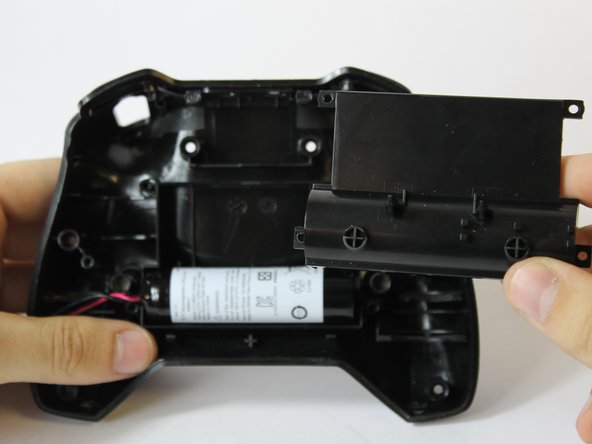

  6. Nvidia Shield TV 1st Generation Controller Battery Replacement: crwdns2935265:06crwdnd2935265:01crwdnd2935265:03crwdne2935265:0 Nvidia Shield TV 1st Generation Controller Battery Replacement: crwdns2935265:06crwdnd2935265:02crwdnd2935265:03crwdne2935265:0 Nvidia Shield TV 1st Generation Controller Battery Replacement: crwdns2935265:06crwdnd2935265:03crwdnd2935265:03crwdne2935265:0
    • Using the T6 Torx screwdriver, remove the indicated four screws from the panel.
    • Remove the panel from the front case.
    • Lift the battery from the front case to remove it.
