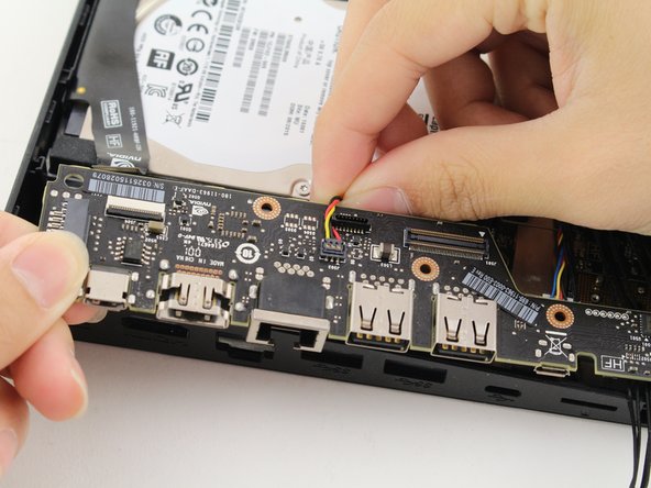

    1. Nvidia Shield Pro Android TV I/O Board Replacement, I/O Board: crwdns2935265:07crwdnd2935265:01crwdnd2935265:03crwdne2935265:0 Nvidia Shield Pro Android TV I/O Board Replacement, I/O Board: crwdns2935265:07crwdnd2935265:02crwdnd2935265:03crwdne2935265:0 Nvidia Shield Pro Android TV I/O Board Replacement, I/O Board: crwdns2935265:07crwdnd2935265:03crwdnd2935265:03crwdne2935265:0
      • Detach the brown side of the connector from the I/O board by pulling it upward.
      • Remove the screw from the silver plate using a T6 Torx screwdriver.
      • Put the cable aside after removing it.
    2. Nvidia Shield Pro Android TV I/O Board Replacement: crwdns2935265:08crwdnd2935265:01crwdnd2935265:02crwdne2935265:0 Nvidia Shield Pro Android TV I/O Board Replacement: crwdns2935265:08crwdnd2935265:02crwdnd2935265:02crwdne2935265:0
      • Detach the small bundle of black wires from the I/O board by gently pulling upward.
      • Be very gentle because the wires are very fragile.
    3. Nvidia Shield Pro Android TV I/O Board Replacement: crwdns2935265:09crwdnd2935265:01crwdnd2935265:02crwdne2935265:0 Nvidia Shield Pro Android TV I/O Board Replacement: crwdns2935265:09crwdnd2935265:02crwdnd2935265:02crwdne2935265:0
      • Remove the three T6 Torx screws from the I/O board.
    4. Nvidia Shield Pro Android TV I/O Board Replacement: crwdns2935265:010crwdnd2935265:01crwdnd2935265:03crwdne2935265:0 Nvidia Shield Pro Android TV I/O Board Replacement: crwdns2935265:010crwdnd2935265:02crwdnd2935265:03crwdne2935265:0 Nvidia Shield Pro Android TV I/O Board Replacement: crwdns2935265:010crwdnd2935265:03crwdnd2935265:03crwdne2935265:0
      • Detach the multi-colored (red/yellow/black) wire from the I/O board by pulling it away from the socket.
    5. Nvidia Shield Pro Android TV I/O Board Replacement: crwdns2935265:011crwdnd2935265:01crwdnd2935265:01crwdne2935265:0
      • Gently remove the I/O board by sliding it away from the exterior input/output sockets on your Nvidia Shield Pro.
