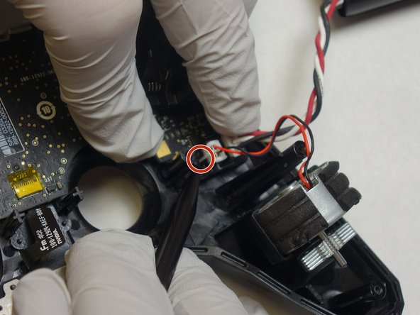

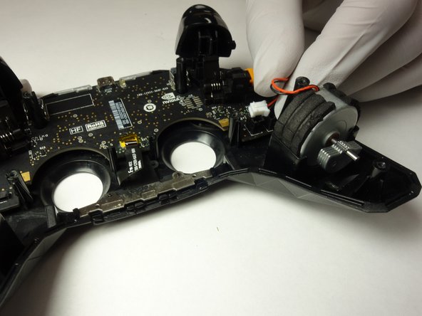

  6. Nvidia Shield Pro Android TV Controller Rumble Motor Replacement, Rumble Motors: crwdns2935265:06crwdnd2935265:01crwdnd2935265:03crwdne2935265:0 Nvidia Shield Pro Android TV Controller Rumble Motor Replacement, Rumble Motors: crwdns2935265:06crwdnd2935265:02crwdnd2935265:03crwdne2935265:0 Nvidia Shield Pro Android TV Controller Rumble Motor Replacement, Rumble Motors: crwdns2935265:06crwdnd2935265:03crwdnd2935265:03crwdne2935265:0
    • Grip the plugs as close to their ports as possible and pull them directly up and out.
    • Lift the rumble motors up and out of the chassis.
