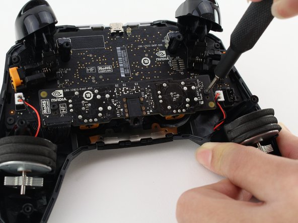

      • Carefully remove the two T6 Torx screws from either side of the motherboard.
    6. Nvidia Shield Pro Android TV Controller D-Pad Replacement: crwdns2935265:06crwdnd2935265:01crwdnd2935265:01crwdne2935265:0
      • Remove the yellow plug from its socket.
    7. Nvidia Shield Pro Android TV Controller D-Pad Replacement: crwdns2935265:07crwdnd2935265:01crwdnd2935265:02crwdne2935265:0 Nvidia Shield Pro Android TV Controller D-Pad Replacement: crwdns2935265:07crwdnd2935265:02crwdnd2935265:02crwdne2935265:0
      • Remove the two T6 Torx screws.
    8. Nvidia Shield Pro Android TV Controller D-Pad Replacement: crwdns2935265:08crwdnd2935265:01crwdnd2935265:01crwdne2935265:0
      • Slowly pull up the primary circuit board of the controller until the D-pad is revealed.
      • Carefully remove the board.
