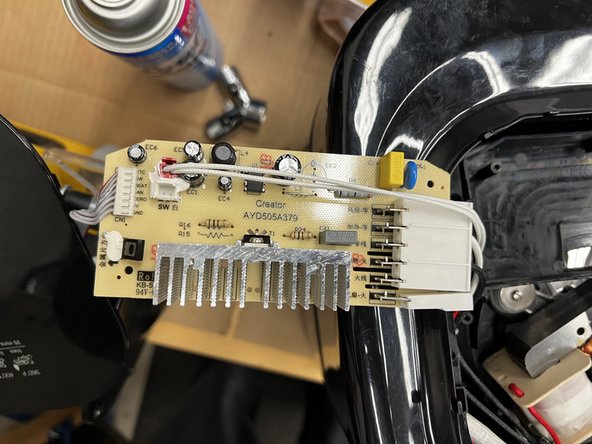

    • There are 2 screws inside the cooking chamber.
  1. Nuwave Brio 6Q Air Fryer Disassembly, Popping Out the Clips: crwdns2935265:02crwdnd2935265:01crwdnd2935265:03crwdne2935265:0 Nuwave Brio 6Q Air Fryer Disassembly, Popping Out the Clips: crwdns2935265:02crwdnd2935265:02crwdnd2935265:03crwdne2935265:0 Nuwave Brio 6Q Air Fryer Disassembly, Popping Out the Clips: crwdns2935265:02crwdnd2935265:03crwdnd2935265:03crwdne2935265:0
    • The top will pop off at these clips, use a tool or your fingers to gently pull.
  2. Nuwave Brio 6Q Air Fryer Disassembly, Remove the Circuit Board: crwdns2935265:03crwdnd2935265:01crwdnd2935265:02crwdne2935265:0 Nuwave Brio 6Q Air Fryer Disassembly, Remove the Circuit Board: crwdns2935265:03crwdnd2935265:02crwdnd2935265:02crwdne2935265:0
    • Remove the screws to remove the circuit board.
    • The safety switch is what was bad on this one. I replaced it with one from eBay.

In the last video u showed how the top was and the switch u was going to change, how did u get the top lid off, took the 4 screws out but still didn’t pop off
Dale Lindsey - crwdns2934203:0crwdne2934203:0
I too want to determine how you got the top off by two screws? We need a complete video to see how to do it.
