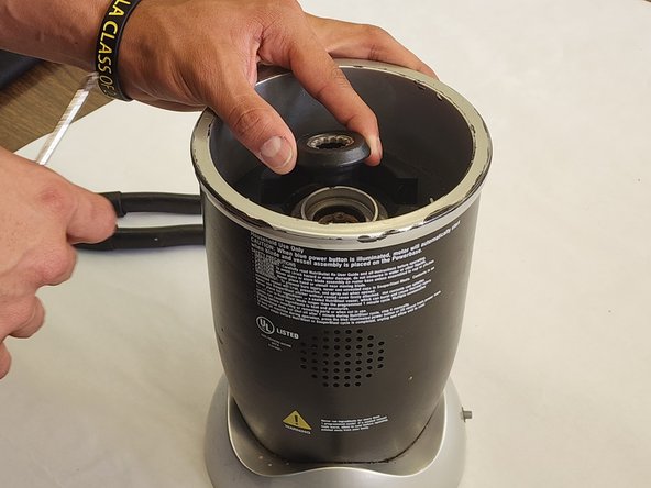

  1. Nutribullet Rx #NB-301 Drive Socket Replacement, Drive Socket: crwdns2935265:01crwdnd2935265:01crwdnd2935265:03crwdne2935265:0 Nutribullet Rx #NB-301 Drive Socket Replacement, Drive Socket: crwdns2935265:01crwdnd2935265:02crwdnd2935265:03crwdne2935265:0 Nutribullet Rx #NB-301 Drive Socket Replacement, Drive Socket: crwdns2935265:01crwdnd2935265:03crwdnd2935265:03crwdne2935265:0

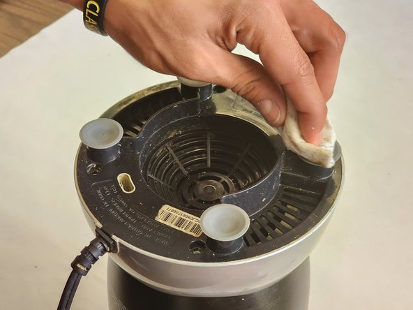

    • Make sure to unplug the device before you start the repair.
    • Flip the blender over so the bottom is facing up.
    • Use a Phillips #2 screwdriver to remove the four 10 mm screws from the base of the blender.
    • Remove the base cover from the blender.
  2. Nutribullet Rx #NB-301 Drive Socket Replacement: crwdns2935265:02crwdnd2935265:01crwdnd2935265:02crwdne2935265:0 Nutribullet Rx #NB-301 Drive Socket Replacement: crwdns2935265:02crwdnd2935265:02crwdnd2935265:02crwdne2935265:0

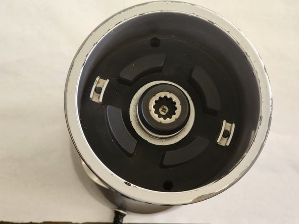

    • Clamp down on the nut above the socket with the needle nose pliers so it stays in place for the next step.
  3. Nutribullet Rx #NB-301 Drive Socket Replacement: crwdns2935265:03crwdnd2935265:01crwdnd2935265:03crwdne2935265:0 Nutribullet Rx #NB-301 Drive Socket Replacement: crwdns2935265:03crwdnd2935265:02crwdnd2935265:03crwdne2935265:0 Nutribullet Rx #NB-301 Drive Socket Replacement: crwdns2935265:03crwdnd2935265:03crwdnd2935265:03crwdne2935265:0

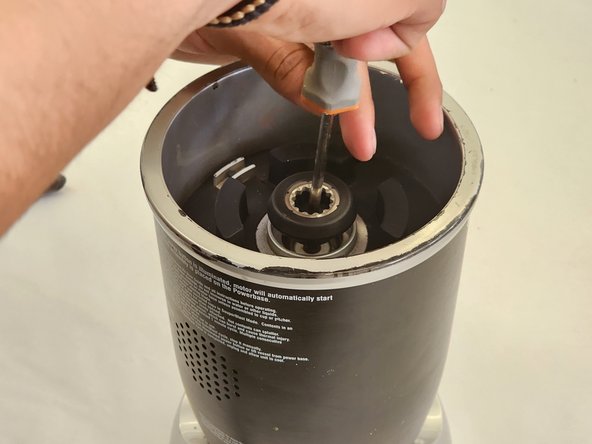

    • Lay the blender on its side and hold the drive socket with the needle nose pliers to keep in from turning so you can remove the screw.
    • Use a Phillips #2 screwdriver to remove the screw securing the drive socket.

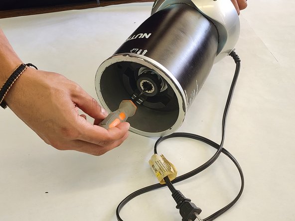

  4. Nutribullet Rx #NB-301 Drive Socket Replacement: crwdns2935265:04crwdnd2935265:01crwdnd2935265:03crwdne2935265:0 Nutribullet Rx #NB-301 Drive Socket Replacement: crwdns2935265:04crwdnd2935265:02crwdnd2935265:03crwdne2935265:0 Nutribullet Rx #NB-301 Drive Socket Replacement: crwdns2935265:04crwdnd2935265:03crwdnd2935265:03crwdne2935265:0
    • Remove the drive socket from the motor.

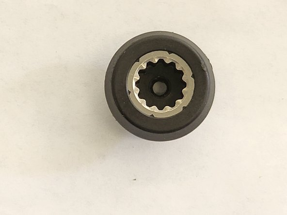

  5. Nutribullet Rx #NB-301 Drive Socket Replacement: crwdns2935265:05crwdnd2935265:01crwdnd2935265:03crwdne2935265:0 Nutribullet Rx #NB-301 Drive Socket Replacement: crwdns2935265:05crwdnd2935265:02crwdnd2935265:03crwdne2935265:0 Nutribullet Rx #NB-301 Drive Socket Replacement: crwdns2935265:05crwdnd2935265:03crwdnd2935265:03crwdne2935265:0
    • Remove all dust and residue from the area before you replace your new drive socket.

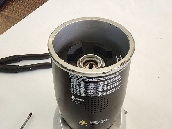

  6. Nutribullet Rx #NB-301 Drive Socket Replacement: crwdns2935265:06crwdnd2935265:01crwdnd2935265:03crwdne2935265:0 Nutribullet Rx #NB-301 Drive Socket Replacement: crwdns2935265:06crwdnd2935265:02crwdnd2935265:03crwdne2935265:0 Nutribullet Rx #NB-301 Drive Socket Replacement: crwdns2935265:06crwdnd2935265:03crwdnd2935265:03crwdne2935265:0
    • Use a Phillips #2 screwdriver to secure the drive socket to the motor.
  7. Nutribullet Rx #NB-301 Drive Socket Replacement: crwdns2935265:07crwdnd2935265:01crwdnd2935265:02crwdne2935265:0 Nutribullet Rx #NB-301 Drive Socket Replacement: crwdns2935265:07crwdnd2935265:02crwdnd2935265:02crwdne2935265:0
    • Place the bottom cover back on the blender.
    • Use the Phillips #2 screwdriver to replace the four 10 mm screws on the back cover back.
