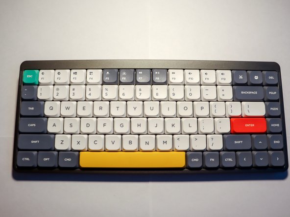

    • Place your keyboard on a clean, well-lit surface.
    • Slide the keyboard power switch to the "off" position.

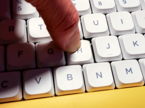

    • Find the wire side of the keycap puller. Slide each wire around opposite sides of the key you are replacing.
    • Pull gently until the key cap comes off.
    • Pull the keycap straight up. This will prevent damage to adjacent keycaps.

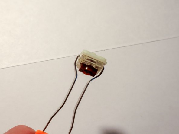

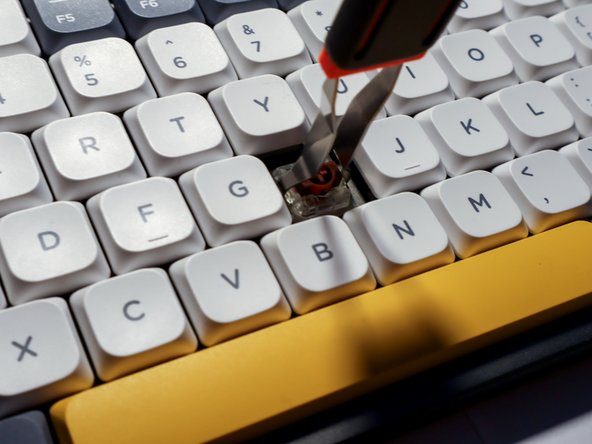

    • Use the other side of the switch puller, with two large metal prongs. Fit the prongs onto either side of the switch.
    • Pull the switch out using a side-to-side motion. When one side of the switch lifts up with an audible click, gently lift the other side to fully remove the switch.
    • Do not rock side-to-side into other keys. You can damage adjacent keycaps and the keyboard itself.
