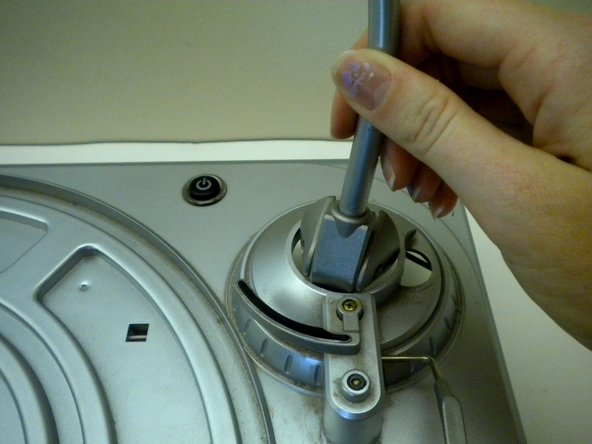

    • Flip the turntable back over to the top side.
    • Remove the counter weight located at the back of the tone arm.
  9. Numark TT1600 Tone Arm Replacement: crwdns2935265:09crwdnd2935265:01crwdnd2935265:03crwdne2935265:0 Numark TT1600 Tone Arm Replacement: crwdns2935265:09crwdnd2935265:02crwdnd2935265:03crwdne2935265:0 Numark TT1600 Tone Arm Replacement: crwdns2935265:09crwdnd2935265:03crwdnd2935265:03crwdne2935265:0
    • Push out the pin keeping the tone arm in place using a Phillips #00 screwdriver.
    • Once you have pushed the pin out with the screwdriver, pull the rest of it out using your hand.

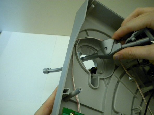

  10. Numark TT1600 Tone Arm Replacement: crwdns2935265:010crwdnd2935265:01crwdnd2935265:03crwdne2935265:0 Numark TT1600 Tone Arm Replacement: crwdns2935265:010crwdnd2935265:02crwdnd2935265:03crwdne2935265:0 Numark TT1600 Tone Arm Replacement: crwdns2935265:010crwdnd2935265:03crwdnd2935265:03crwdne2935265:0
    • Pick up the tone arm and point the back end of it towards its base.
    • Push the back end of the tone arm into the hole.
    • Flip the turntable over and pull the tone arm all the way through the hole.
