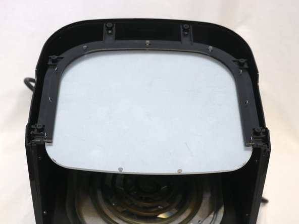

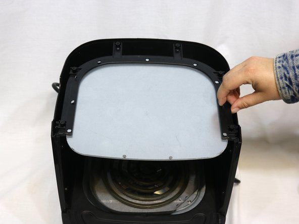

    • Use your finger to flip up each small metal tab located around the heating plate.
    • The plate may fall when all tabs have been flipped up.
    • Photos #2 and #3 both display an additional piece removed, which lines the edge of the basket area. Removing this is entirely unnecessary and included solely for the visibility of this guide.
  4. NuWave Brio 37001 Heating Plate Replacement: crwdns2935265:04crwdnd2935265:01crwdnd2935265:01crwdne2935265:0
    • After flipping each tab, remove the plate by pushing downwards on its surface.
