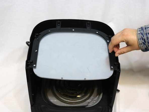

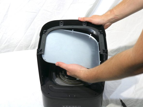

  3. NuWave Brio 37001 Convection Fan Replacement: crwdns2935265:03crwdnd2935265:01crwdnd2935265:03crwdne2935265:0 NuWave Brio 37001 Convection Fan Replacement: crwdns2935265:03crwdnd2935265:02crwdnd2935265:03crwdne2935265:0 NuWave Brio 37001 Convection Fan Replacement: crwdns2935265:03crwdnd2935265:03crwdnd2935265:03crwdne2935265:0
    • Use your finger to flip up each small metal tab located around the heating plate.
    • The plate may fall when all tabs have been flipped up.
    • Photos #2 and #3 both display an additional piece removed, which lines the edge of the basket area. Removing this is entirely unnecessary and included solely for the visibility of this guide.

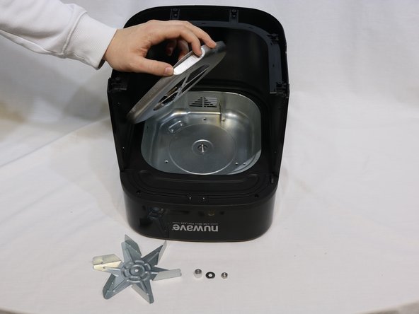

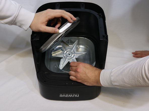

  5. NuWave Brio 37001 Convection Fan Replacement: crwdns2935265:05crwdnd2935265:01crwdnd2935265:02crwdne2935265:0 NuWave Brio 37001 Convection Fan Replacement: crwdns2935265:05crwdnd2935265:02crwdnd2935265:02crwdne2935265:0
    • This step is easier with help. You will need two hands to unscrew the bolt and turn the fan simultaneously.
    • Gently apply the pliers around the bolt in the middle of the fan blade and keep it there while you place your other hand onto the fan blade itself.
    • Simultaneously hold the pliers in place to keep the bolt from spinning and turn the fan blade counterclockwise with force, as seen in the first picture.
    • Turning the fan blade may require substantial force; be careful while removing due to a sudden jolt when loose.
    • The bolt should become loose allowing you to remove the fan blade from its place, as seen in picture 2.
  6. NuWave Brio 37001 Convection Fan Replacement: crwdns2935265:06crwdnd2935265:01crwdnd2935265:02crwdne2935265:0 NuWave Brio 37001 Convection Fan Replacement: crwdns2935265:06crwdnd2935265:02crwdnd2935265:02crwdne2935265:0
    • Make sure to gather the nut and washer found beneath the fan blade once removed.
