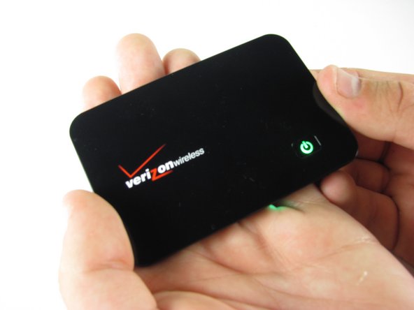

    • Remove the rear cover by pressing down on the cover and pulling it away from the device.
  2. Novatel MiFi 2200 Circuit Board Replacement: crwdns2935265:02crwdnd2935265:01crwdnd2935265:01crwdne2935265:0
    • Place your finger on the back of the battery located near the edge of the device.
    • Push your finger into the battery and lift up to pop the battery out of the device.

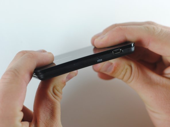

  3. Novatel MiFi 2200 Circuit Board Replacement, Case: crwdns2935265:03crwdnd2935265:01crwdnd2935265:01crwdne2935265:0
    • Using a metal spudger, pry open the device around the seam between the front and back cover.
    • It may be difficult to split apart, so use force with caution.
    • It may seem like you are breaking the device, but you will only be breaking the adhesive lining that keeps the device sealed.
