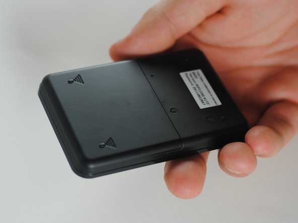

    • Remove the rear cover by pressing down on the cover and pulling it away from the device.
  2. Novatel MiFi 2200 Battery Replacement: crwdns2935265:02crwdnd2935265:01crwdnd2935265:01crwdne2935265:0
    • Place your finger on the back of the battery located near the edge of the device.
    • Push your finger into the battery and lift up to pop the battery out of the device.
  3. Novatel MiFi 2200 Battery Replacement: crwdns2935265:03crwdnd2935265:01crwdnd2935265:01crwdne2935265:0
    • Insert the new battery into the battery slot.
    • Make sure to place the battery in with the white arrows facing inward.
  4. Novatel MiFi 2200 Battery Replacement: crwdns2935265:04crwdnd2935265:01crwdnd2935265:02crwdne2935265:0 Novatel MiFi 2200 Battery Replacement: crwdns2935265:04crwdnd2935265:02crwdnd2935265:02crwdne2935265:0
    • Re-install the rear cover by placing the inward end in it's slot.
    • Push down on the cover while sliding it into the slot to snap it back into place.
Charge your new battery and you are ready to use your Mifi again.
