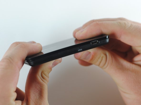

  3. Novatel MiFi 2200 Antenna Replacement, Case: crwdns2935265:03crwdnd2935265:01crwdnd2935265:01crwdne2935265:0
    • Using a metal spudger, pry open the device around the seam between the front and back cover.
    • It may be difficult to split apart, so use force with caution.
    • It may seem like you are breaking the device, but you will only be breaking the adhesive lining that keeps the device sealed.

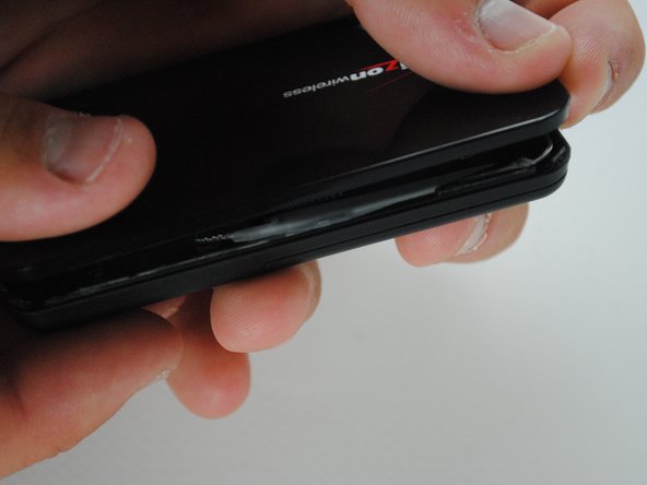

  4. Novatel MiFi 2200 Antenna Replacement: crwdns2935265:04crwdnd2935265:01crwdnd2935265:01crwdne2935265:0
    • Once the seal has been broken all the way around, open the cases using your hands.
