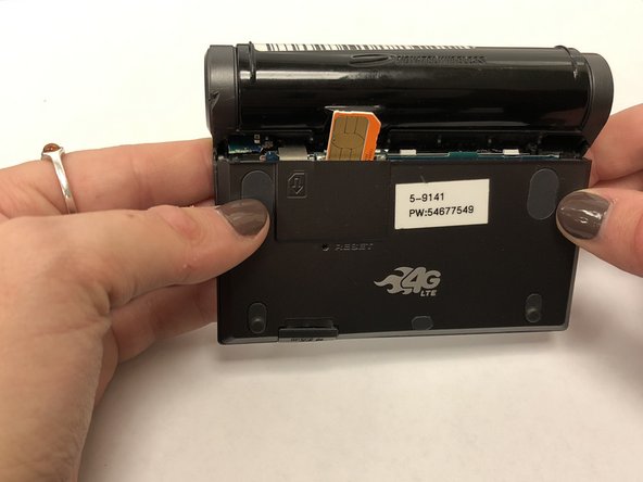

      • Unplug the charger from your Novatel Hotspot device.
      • Place the Novatel Hotspot device face down on a flat, clean surface.
      • Place your thumb under the latch of the black plastic battery cover as shown.
      • Remove the battery cover. This will require some force.
    1. Novatel MiFi 2 4G LTE Hotspot  SIM Card  Replacement, Battery: crwdns2935265:02crwdnd2935265:01crwdnd2935265:02crwdne2935265:0 Novatel MiFi 2 4G LTE Hotspot  SIM Card  Replacement, Battery: crwdns2935265:02crwdnd2935265:02crwdnd2935265:02crwdne2935265:0
      • Gently place your thumb on the right side of the battery as shown.
      • Remove the battery from its socket by lifting it up and out.

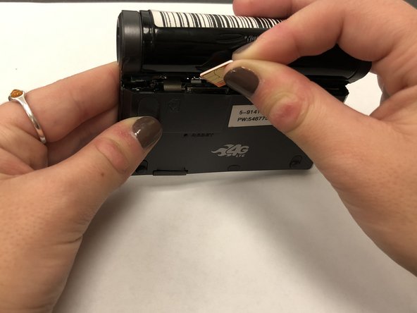

    1. Novatel MiFi 2 4G LTE Hotspot  SIM Card  Replacement, SIM Card: crwdns2935265:03crwdnd2935265:01crwdnd2935265:03crwdne2935265:0 Novatel MiFi 2 4G LTE Hotspot  SIM Card  Replacement, SIM Card: crwdns2935265:03crwdnd2935265:02crwdnd2935265:03crwdne2935265:0 Novatel MiFi 2 4G LTE Hotspot  SIM Card  Replacement, SIM Card: crwdns2935265:03crwdnd2935265:03crwdnd2935265:03crwdne2935265:0
      • Once the battery has been removed, the SIM Card slot can be accessed.
      • Carefully take out the dead SIM Card by lifting it from its position with your fingers.
