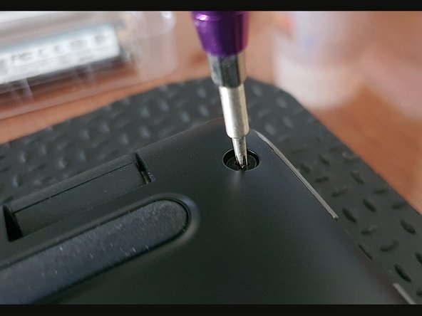

  1. Notebook ASUS VIVOBOOK X512FJ memory Replacement, Open back cover: crwdns2935265:01crwdnd2935265:01crwdnd2935265:03crwdne2935265:0 Notebook ASUS VIVOBOOK X512FJ memory Replacement, Open back cover: crwdns2935265:01crwdnd2935265:02crwdnd2935265:03crwdne2935265:0 Notebook ASUS VIVOBOOK X512FJ memory Replacement, Open back cover: crwdns2935265:01crwdnd2935265:03crwdnd2935265:03crwdne2935265:0
    • Remove all screws shown in the image
  2. Notebook ASUS VIVOBOOK X512FJ memory Replacement, Save the screws: crwdns2935265:02crwdnd2935265:01crwdnd2935265:01crwdne2935265:0
    • The bottom screws are different

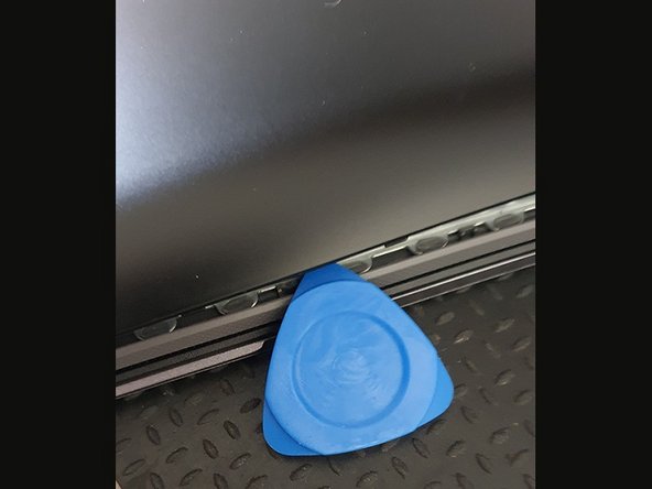

  3. Notebook ASUS VIVOBOOK X512FJ memory Replacement, Remove back cover: crwdns2935265:03crwdnd2935265:01crwdnd2935265:03crwdne2935265:0 Notebook ASUS VIVOBOOK X512FJ memory Replacement, Remove back cover: crwdns2935265:03crwdnd2935265:02crwdnd2935265:03crwdne2935265:0 Notebook ASUS VIVOBOOK X512FJ memory Replacement, Remove back cover: crwdns2935265:03crwdnd2935265:03crwdnd2935265:03crwdne2935265:0
    • Open the back cover carefully using a plastic tool that will not damage the cover.
    • Start at the bottom.
    • Continue along the lid

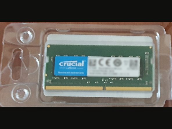

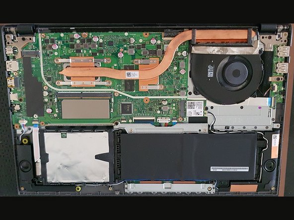

  4. Notebook ASUS VIVOBOOK X512FJ memory Replacement, Install the new memory: crwdns2935265:04crwdnd2935265:01crwdnd2935265:02crwdne2935265:0 Notebook ASUS VIVOBOOK X512FJ memory Replacement, Install the new memory: crwdns2935265:04crwdnd2935265:02crwdnd2935265:02crwdne2935265:0
    • Remove the installed memory.
    • Remove the heatsinks (on both sides)
    • Install the new memory
