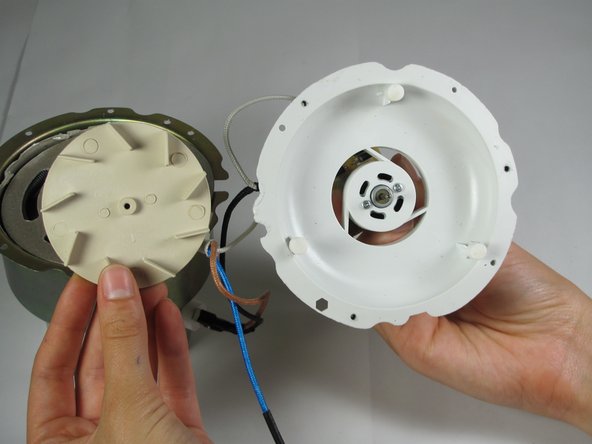

  9. Nostalgia Electrics RHP-310 Wiring Repair, Replacing Fan: crwdns2935265:09crwdnd2935265:01crwdnd2935265:01crwdne2935265:0
    • Unscrew the three 10 mm Philips #2 screws that hold the heating component together.
    • Keep the screws in a safe place. You will need them to put the heating component back together.
  10. Nostalgia Electrics RHP-310 Wiring Repair: crwdns2935265:010crwdnd2935265:01crwdnd2935265:01crwdne2935265:0
    • Pull the heating component apart.
  11. Nostalgia Electrics RHP-310 Wiring Repair: crwdns2935265:011crwdnd2935265:01crwdnd2935265:02crwdne2935265:0 Nostalgia Electrics RHP-310 Wiring Repair: crwdns2935265:011crwdnd2935265:02crwdnd2935265:02crwdne2935265:0
    • Locate the fan.
    • Pull the fan off the motor.
    • Do not pull too hard or you will break the motor.
  12. Nostalgia Electrics RHP-310 Wiring Repair: crwdns2935265:012crwdnd2935265:01crwdnd2935265:01crwdne2935265:0
    • You can now replace the fan. If there is debris, clean it out.
