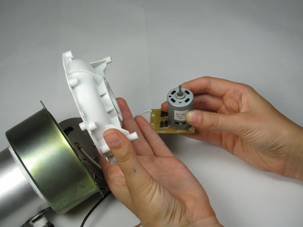

  12. Nostalgia Electrics RHP-310 Motor Replacement: crwdns2935265:012crwdnd2935265:01crwdnd2935265:01crwdne2935265:0
    • You can now replace the fan. If there is debris, clean it out.
  13. Nostalgia Electrics RHP-310 Motor Replacement, Motor: crwdns2935265:013crwdnd2935265:01crwdnd2935265:02crwdne2935265:0 Nostalgia Electrics RHP-310 Motor Replacement, Motor: crwdns2935265:013crwdnd2935265:02crwdnd2935265:02crwdne2935265:0
    • Use a Phillips #0 screwdriver to remove the two 2.5mm screws connecting the motor to the fan base.
    • Remember to keep the screws. You will need them to reassemble the popper.
    • Remove the motor from the fan base.
  14. Nostalgia Electrics RHP-310 Motor Replacement: crwdns2935265:014crwdnd2935265:01crwdnd2935265:01crwdne2935265:0
    • Un-solder the wires that are connected to the motor.
  15. Nostalgia Electrics RHP-310 Motor Replacement: crwdns2935265:015crwdnd2935265:01crwdnd2935265:01crwdne2935265:0
    • Replace the old motor by soldering the new motor to the circuit board.
