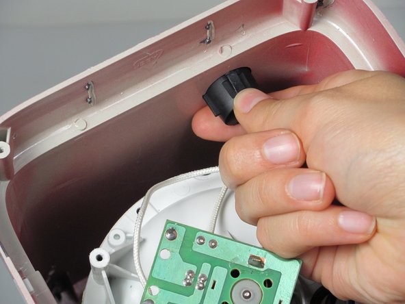

  4. Nostalgia Electrics RHP-310 Housing Replacement: crwdns2935265:04crwdnd2935265:01crwdnd2935265:02crwdne2935265:0 Nostalgia Electrics RHP-310 Housing Replacement: crwdns2935265:04crwdnd2935265:02crwdnd2935265:02crwdne2935265:0
    • Locate the power switch connected to the side of the housing.
    • Pinch the sides of the power switch.
    • Push the power button up and out of the housing.
  5. Nostalgia Electrics RHP-310 Housing Replacement: crwdns2935265:05crwdnd2935265:01crwdnd2935265:01crwdne2935265:0
    • Remove the wires connected to the power switch that should be detached from the housing.
    • Gently pry the wires loose from the power switch with the plastic opening tool.
    • The wires should easily pop out from the power switch.
  6. Nostalgia Electrics RHP-310 Housing Replacement: crwdns2935265:06crwdnd2935265:01crwdnd2935265:01crwdne2935265:0
    • Remove the power switch from the housing unit.
    • You can now replace the power switch, if necessary.

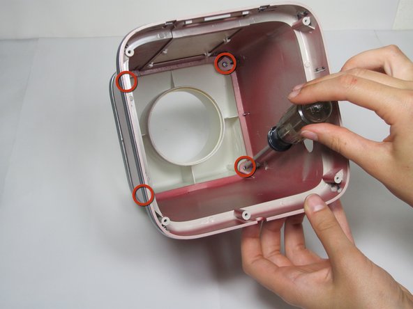

  7. Nostalgia Electrics RHP-310 Housing Replacement, Housing: crwdns2935265:07crwdnd2935265:01crwdnd2935265:02crwdne2935265:0 Nostalgia Electrics RHP-310 Housing Replacement, Housing: crwdns2935265:07crwdnd2935265:02crwdnd2935265:02crwdne2935265:0
    • Gently remove the heating component from the popper.
    • Unscrew the four screws (11mm Philips #2 screws) that connect the white top to the housing.
    • Save the screws from this step. You will need them to connect the new housing to the white top.
  8. Nostalgia Electrics RHP-310 Housing Replacement: crwdns2935265:08crwdnd2935265:01crwdnd2935265:01crwdne2935265:0
    • Remove the white top from the housing.
