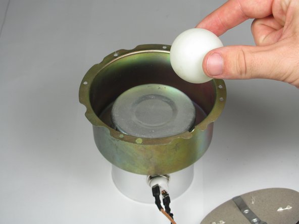

  7. Nostalgia Electrics RHP-310 Disassembly for cleaning, Housing: crwdns2935265:07crwdnd2935265:01crwdnd2935265:02crwdne2935265:0 Nostalgia Electrics RHP-310 Disassembly for cleaning, Housing: crwdns2935265:07crwdnd2935265:02crwdnd2935265:02crwdne2935265:0
    • Gently remove the heating component from the popper.
    • Unscrew the four screws (11mm Philips #2 screws) that connect the white top to the housing.
    • Save the screws from this step. You will need them to connect the new housing to the white top.
  8. Nostalgia Electrics RHP-310 Disassembly for cleaning: crwdns2935265:08crwdnd2935265:01crwdnd2935265:01crwdne2935265:0
    • Remove the white top from the housing.

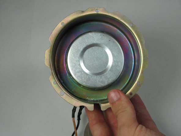

  9. Nostalgia Electrics RHP-310 Disassembly for cleaning, Replacing Fan: crwdns2935265:09crwdnd2935265:01crwdnd2935265:01crwdne2935265:0
    • Unscrew the three 10 mm Philips #2 screws that hold the heating component together.
    • Keep the screws in a safe place. You will need them to put the heating component back together.
  10. Nostalgia Electrics RHP-310 Disassembly for cleaning: crwdns2935265:010crwdnd2935265:01crwdnd2935265:01crwdne2935265:0
    • Pull the heating component apart.
  11. Nostalgia Electrics RHP-310 Disassembly for cleaning: crwdns2935265:011crwdnd2935265:01crwdnd2935265:02crwdne2935265:0 Nostalgia Electrics RHP-310 Disassembly for cleaning: crwdns2935265:011crwdnd2935265:02crwdnd2935265:02crwdne2935265:0
    • Locate the fan.
    • Pull the fan off the motor.
    • Do not pull too hard or you will break the motor.
  12. Nostalgia Electrics RHP-310 Disassembly for cleaning: crwdns2935265:012crwdnd2935265:01crwdnd2935265:01crwdne2935265:0
    • You can now replace the fan. If there is debris, clean it out.
  13. Nostalgia Electrics RHP-310 Disassembly for cleaning, Nostalgia Electrics RHP-310 Disassembly for cleaning: crwdns2935265:013crwdnd2935265:01crwdnd2935265:01crwdne2935265:0
    • Remove the heating coil out of the heating component.
  14. Nostalgia Electrics RHP-310 Disassembly for cleaning: crwdns2935265:014crwdnd2935265:01crwdnd2935265:03crwdne2935265:0 Nostalgia Electrics RHP-310 Disassembly for cleaning: crwdns2935265:014crwdnd2935265:02crwdnd2935265:03crwdne2935265:0 Nostalgia Electrics RHP-310 Disassembly for cleaning: crwdns2935265:014crwdnd2935265:03crwdnd2935265:03crwdne2935265:0
    • Visually check for debris.
    • Remove debris.
