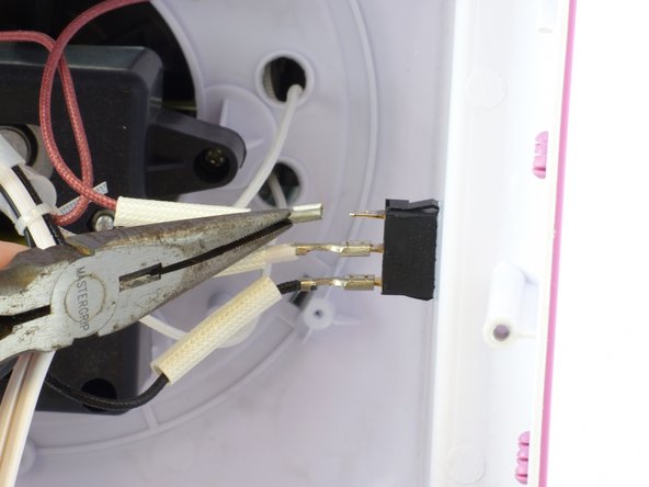

    • Note the color of each wire and the order you remove them.
    • Using a pair of pliers, firmly grip the base of the wire.
    • Be sure to grip where the connector meets the wire and not where the connector covers the switch prong.
    • Pull the wire straight out of the switch.
    • Repeat this step for each wire.

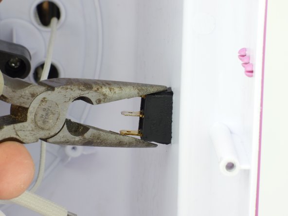

    • Using pliers, pinch tabs at the top and bottom of switch.
    • While pinching the tabs, push the switch until the tabs are on the outside of the device.

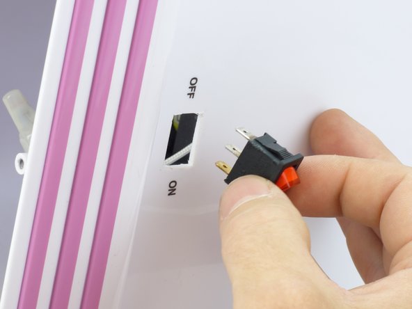

    • Remove the switch from the device.
