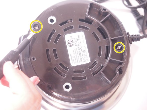

  3. Nostalgia Chocolate Fondue Fountain CFF965 Disassembly: crwdns2935265:03crwdnd2935265:01crwdnd2935265:01crwdne2935265:0
    • Flip the base over.
    • Unscrew the 21.3 mm "feet" screws by hand.

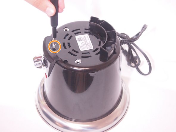

  4. Nostalgia Chocolate Fondue Fountain CFF965 Disassembly: crwdns2935265:04crwdnd2935265:01crwdnd2935265:03crwdne2935265:0 Nostalgia Chocolate Fondue Fountain CFF965 Disassembly: crwdns2935265:04crwdnd2935265:02crwdnd2935265:03crwdne2935265:0 Nostalgia Chocolate Fondue Fountain CFF965 Disassembly: crwdns2935265:04crwdnd2935265:03crwdnd2935265:03crwdne2935265:0
    • Unscrew the three 14.2 mm screws with a Phillips #2 screwdriver.
    • Unscrew the 9.1 mm screw near the switch with a Phillips #2 screwdriver.
    • Unscrew the two 14.2 mm spanner screws using a spanner screwdriver (size 6).

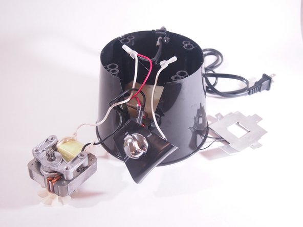

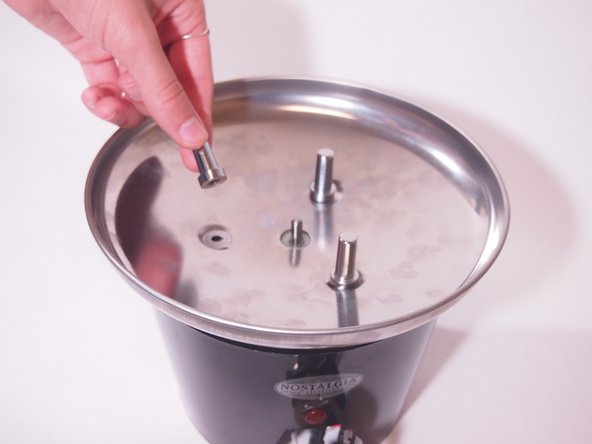

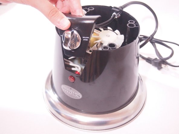

  5. Nostalgia Chocolate Fondue Fountain CFF965 Disassembly: crwdns2935265:05crwdnd2935265:01crwdnd2935265:02crwdne2935265:0 Nostalgia Chocolate Fondue Fountain CFF965 Disassembly: crwdns2935265:05crwdnd2935265:02crwdnd2935265:02crwdne2935265:0
    • Pull up on the baseplate by hand to remove it.
    • Pull the switch component up by hand.

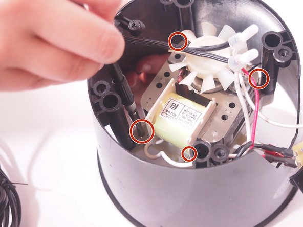

  7. Nostalgia Chocolate Fondue Fountain CFF965 Disassembly: crwdns2935265:07crwdnd2935265:01crwdnd2935265:03crwdne2935265:0 Nostalgia Chocolate Fondue Fountain CFF965 Disassembly: crwdns2935265:07crwdnd2935265:02crwdnd2935265:03crwdne2935265:0 Nostalgia Chocolate Fondue Fountain CFF965 Disassembly: crwdns2935265:07crwdnd2935265:03crwdnd2935265:03crwdne2935265:0
    • Unscrew the three 25.4 mm Phillips #2 sheet metal screws that connect the base bowl to the white plastic structure.
    • When unscrewing, make sure to hold the metal tower studs on the opposite side of the base bowl (see the second picture). This will make it easier to unscrew the screws.
    • Flip the base over and remove the base bowl by hand.

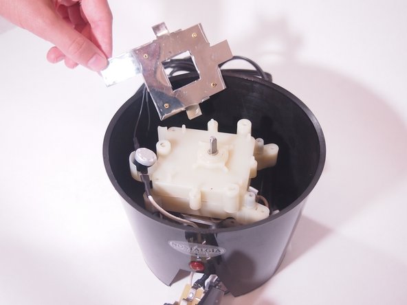

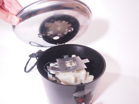

  9. Nostalgia Chocolate Fondue Fountain CFF965 Disassembly: crwdns2935265:09crwdnd2935265:01crwdnd2935265:03crwdne2935265:0 Nostalgia Chocolate Fondue Fountain CFF965 Disassembly: crwdns2935265:09crwdnd2935265:02crwdnd2935265:03crwdne2935265:0 Nostalgia Chocolate Fondue Fountain CFF965 Disassembly: crwdns2935265:09crwdnd2935265:03crwdnd2935265:03crwdne2935265:0
    • Flip the entire base over.
    • Lift up the metal heater plate by hand.
    • Remove the top of the white plastic box by hand.

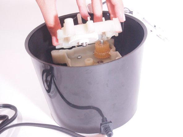

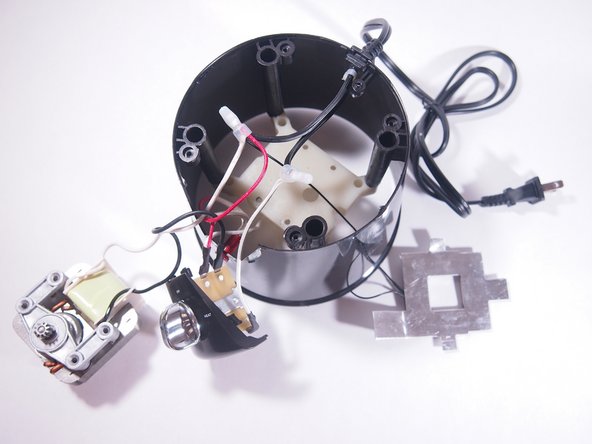

  10. Nostalgia Chocolate Fondue Fountain CFF965 Disassembly: crwdns2935265:010crwdnd2935265:01crwdnd2935265:01crwdne2935265:0
    • Remove the yellow gear.
    • You can use your hands, but we recommend tweezers to avoid touching the lubrication.
  11. Nostalgia Chocolate Fondue Fountain CFF965 Disassembly: crwdns2935265:011crwdnd2935265:01crwdnd2935265:01crwdne2935265:0
    • Unscrew the four 9.1 mm Phillips #2 sheet metal screws.
  12. Nostalgia Chocolate Fondue Fountain CFF965 Disassembly: crwdns2935265:012crwdnd2935265:01crwdnd2935265:03crwdne2935265:0 Nostalgia Chocolate Fondue Fountain CFF965 Disassembly: crwdns2935265:012crwdnd2935265:02crwdnd2935265:03crwdne2935265:0 Nostalgia Chocolate Fondue Fountain CFF965 Disassembly: crwdns2935265:012crwdnd2935265:03crwdnd2935265:03crwdne2935265:0
    • Remove the motor by hand.
