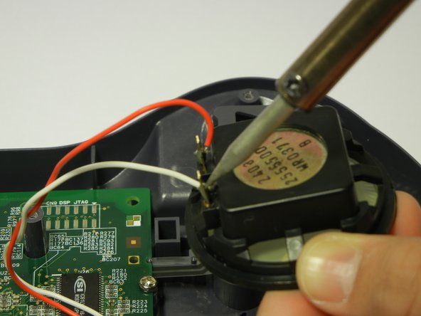

  6. Nortel Networks i2004 IP Speaker Replacement, Speaker: crwdns2935265:06crwdnd2935265:01crwdnd2935265:01crwdne2935265:0
    • Lift the speaker straight up.
    • The speaker may need to be slightly wiggled in order to loosen and remove.
  7. Nortel Networks i2004 IP Speaker Replacement: crwdns2935265:07crwdnd2935265:01crwdnd2935265:01crwdne2935265:0
    • Cut the red and white wires as close to the speaker as possible.
    • Wire cutters are preferred, but normal scissors are fine too.
  8. Nortel Networks i2004 IP Speaker Replacement: crwdns2935265:08crwdnd2935265:01crwdnd2935265:02crwdne2935265:0 Nortel Networks i2004 IP Speaker Replacement: crwdns2935265:08crwdnd2935265:02crwdnd2935265:02crwdne2935265:0
    • Solder wires to new speaker.
