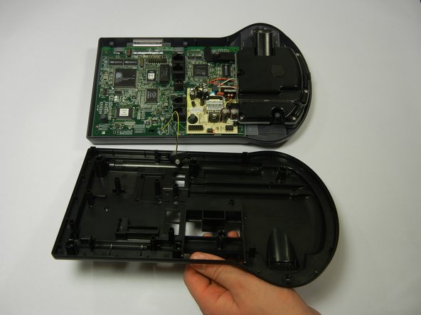

      • Flip the phone over to view the back.
      • Remove the power and phone cords.
    2. Nortel Networks i2004 IP Buttons Replacement: crwdns2935265:02crwdnd2935265:01crwdnd2935265:01crwdne2935265:0
      • Remove the seven 8mm Phillips #2 screws.
    3. Nortel Networks i2004 IP Buttons Replacement: crwdns2935265:03crwdnd2935265:01crwdnd2935265:02crwdne2935265:0 Nortel Networks i2004 IP Buttons Replacement: crwdns2935265:03crwdnd2935265:02crwdnd2935265:02crwdne2935265:0
      • Lift up the back cover slowly because there are still wires attached to the circuit board.
      • Lifting the back cover should not require a lot of force; simply lift with your fingertips.
    4. Nortel Networks i2004 IP Buttons Replacement: crwdns2935265:04crwdnd2935265:01crwdnd2935265:01crwdne2935265:0
      • Disconnect the rubber piece by pulling it out of the slot, freeing the back cover completely.

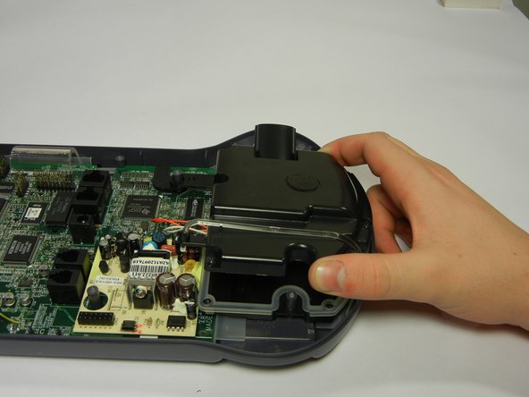

    5. Nortel Networks i2004 IP Buttons Replacement: crwdns2935265:05crwdnd2935265:01crwdnd2935265:02crwdne2935265:0 Nortel Networks i2004 IP Buttons Replacement: crwdns2935265:05crwdnd2935265:02crwdnd2935265:02crwdne2935265:0
      • Remove the six 8mm Phillips #2 screws.
      • Pull the speaker phone cover straight up.

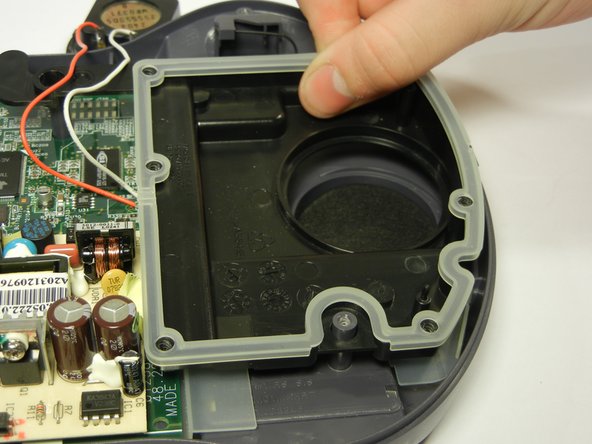

    1. Nortel Networks i2004 IP Buttons Replacement, Circuit Board: crwdns2935265:06crwdnd2935265:01crwdnd2935265:01crwdne2935265:0
      • Remove the red and white wires from the rubber casing rim.
    2. Nortel Networks i2004 IP Buttons Replacement: crwdns2935265:07crwdnd2935265:01crwdnd2935265:02crwdne2935265:0 Nortel Networks i2004 IP Buttons Replacement: crwdns2935265:07crwdnd2935265:02crwdnd2935265:02crwdne2935265:0
      • Lift out the speaker and set it away from the tray that holds it.
      • Then remove the black plastic tray at the bottom by lifting it straight up.

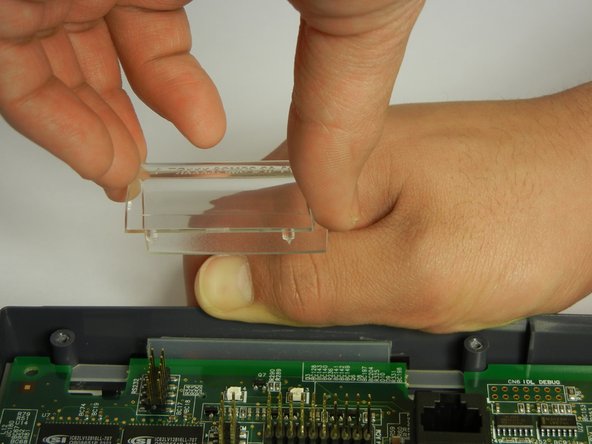

    4. Nortel Networks i2004 IP Buttons Replacement: crwdns2935265:09crwdnd2935265:01crwdnd2935265:02crwdne2935265:0 Nortel Networks i2004 IP Buttons Replacement: crwdns2935265:09crwdnd2935265:02crwdnd2935265:02crwdne2935265:0
      • Pull the gray plastic casing away from the circuit board as you remove the clear, curved, plastic piece straight up.

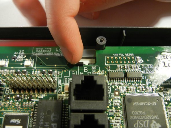

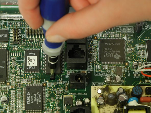

    5. Nortel Networks i2004 IP Buttons Replacement: crwdns2935265:010crwdnd2935265:01crwdnd2935265:03crwdne2935265:0 Nortel Networks i2004 IP Buttons Replacement: crwdns2935265:010crwdnd2935265:02crwdnd2935265:03crwdne2935265:0 Nortel Networks i2004 IP Buttons Replacement: crwdns2935265:010crwdnd2935265:03crwdnd2935265:03crwdne2935265:0
      • There are three clips on the circuit board to un-clip.
      • Unclip both back black clips with your fingertips.
      • Push the middle black clip towards the bottom of the picture with a flathead screwdriver.

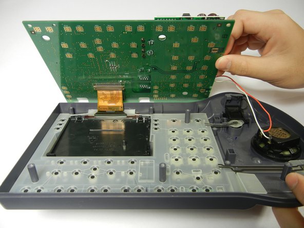

    6. Nortel Networks i2004 IP Buttons Replacement: crwdns2935265:011crwdnd2935265:01crwdnd2935265:02crwdne2935265:0 Nortel Networks i2004 IP Buttons Replacement: crwdns2935265:011crwdnd2935265:02crwdnd2935265:02crwdne2935265:0
      • There's a brown ribbon still attached to the circuit board and phone case, so don't pull the circuit board completely off just yet.
      • Lift the edge of the circuit board over the phone case and slightly up, so the bottom of circuit board can be viewed.
    7. Nortel Networks i2004 IP Buttons Replacement: crwdns2935265:012crwdnd2935265:01crwdnd2935265:01crwdne2935265:0
      • Push down each brown clip on either side of the brown metal strip using your fingertip.
      • Detach the circuit board from the brown ribbon.
    8. Nortel Networks i2004 IP Buttons Replacement: crwdns2935265:013crwdnd2935265:01crwdnd2935265:01crwdne2935265:0
      • Remove the clear rubber casing.
      • Be careful not to flip over the front phone casing or all of the buttons will fall out.
    1. Nortel Networks i2004 IP Buttons Replacement, Buttons: crwdns2935265:014crwdnd2935265:01crwdnd2935265:01crwdne2935265:0
      • Press the broken button from the front of the phone.
      • Remove the broken button through the back.
