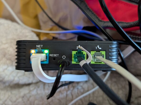

    • Connect your Nortel Millennium to Port 1 on the Grandstream.
    • Connect your USB Modem to Port 2 on the Grandstream and plug in the USB end to your computer of choice.
    • Temporarily unplug the modem in Port 2 and plug in another landline phone.

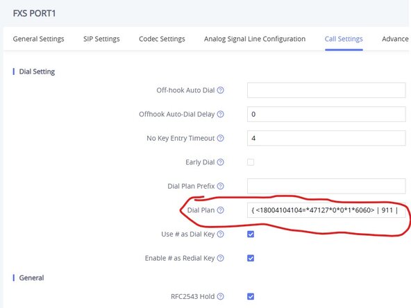

  2. Nortel Millennium Provisioning Setup Guide, Configuring the Grandstream: crwdns2935265:03crwdnd2935265:01crwdnd2935265:01crwdne2935265:0
    • Under Port 1, enter the details for your VoIP provider.
    • Next, go to Port Settings > FXS Port 1 > Analog Signal Line Configuration and enable Polarity Reversal & disable Line Echo Canceller.
    • Additionally, set Jitter Buffer Type to "Fixed" and Jitter Buffer Length to "Low" or "Medium".
    • Note the Port number for Port 2 from the Port Status screen (usually 6060). This number can change when making changes but rebooting the ATA will set it back to 6060.
    • Now go to Port Settings > FXS Port 1 > Call Settings. Under Dial Plan, enter the following: { <18004104104=*47127*0*0*1*6060> | 911 | 411 | 611 | 988 | 1xxxxxxxxxx | [2-9]xxxxxxxxx | 011x+ | x+ | \+x+ | *x+ | *xx*x+ } (This assumes you're using 1-800-410-4104 as your manager number, you can change this)
    • The dial plan will route all calls for 1-800-410-4104 to FXS Port 2, which is your USB modem. This allows the Millennium to talk with mm_manager.

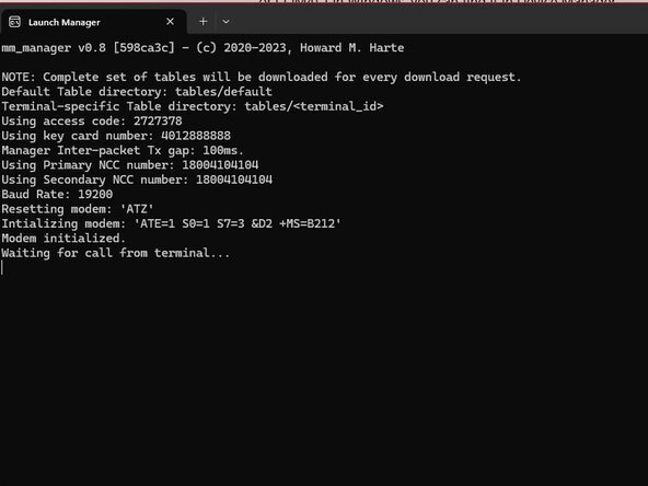

  3. Nortel Millennium Provisioning Setup Guide, Downloading and Setting Up mm_manager: crwdns2935265:04crwdnd2935265:01crwdnd2935265:01crwdne2935265:0
    • Download mm_manager from this link and compile it using the provided instructions.
    • Next, find the COM number your modem is on (Usually COM3 or COM4). On Windows, you can find it in Device Manager.
    • Create a shortcut to mm_manager like this:
    • <path_to_mm_manager.exe> -m -n 18004104104 -f \\.\COM# -vv -l install.dlog -p install.pcap
    • Replace 18004104104 with your manager number and the # after COM with the COM number your modem has.
    • Now start up mm_manager. If everything goes right, you should see "Waiting for call from terminal..." at the bottom of the console window.

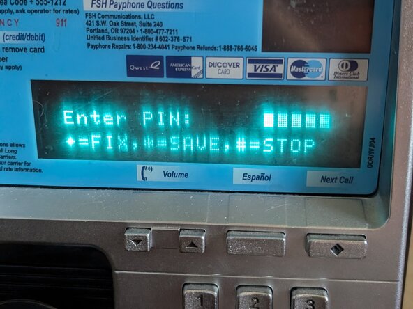

    • When you plug in your phone for the first time, you should see "* out of service *" printed on the bottom line.
    • On the phone's keypad, type 2727378 (CRASERV). When the phone prompts for a PIN, enter any above 50000 and press *.
    • When the phone prompts, unlock the terminal with the T-Key near the top left of the housing. If you're using a desk terminal, specify a card number in mm_manager and insert that card when prompted.
    • On the next screen, press # to install.
