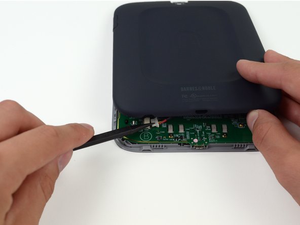

  6. Nook Simple Touch with GlowLight Teardown: crwdns2935265:06crwdnd2935265:01crwdnd2935265:03crwdne2935265:0 Nook Simple Touch with GlowLight Teardown: crwdns2935265:06crwdnd2935265:02crwdnd2935265:03crwdne2935265:0 Nook Simple Touch with GlowLight Teardown: crwdns2935265:06crwdnd2935265:03crwdnd2935265:03crwdne2935265:0
    Spudger
    $3.99
    • As our spudger comes out to disconnect the solitary battery connector, we wait for something along the lines of this to happen.
    • Unfortunately, this is all we get. No glowing aura; no chest full of gold; not even a speck of pixie dust. The only explanation is that the GlowLight must have some other form of mythical power behind it.
