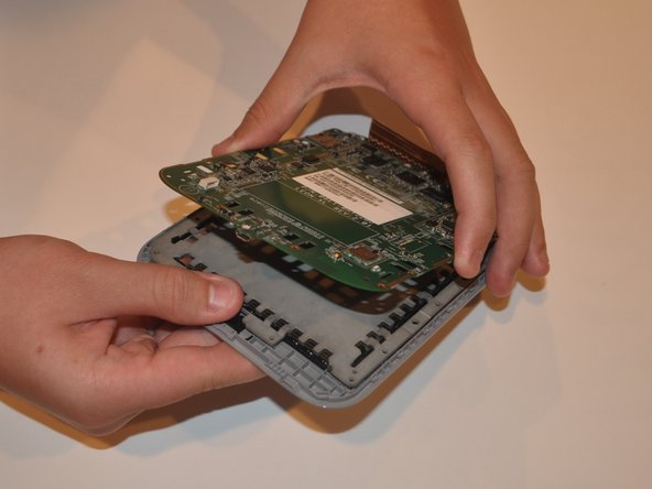

  7. Nook Simple Touch with GlowLight Screen Replacement, Motherboard: crwdns2935265:07crwdnd2935265:01crwdnd2935265:01crwdne2935265:0
    • Remove eleven screws from the motherboard using the T4 screwdriver.
  8. Nook Simple Touch with GlowLight Screen Replacement: crwdns2935265:08crwdnd2935265:01crwdnd2935265:03crwdne2935265:0 Nook Simple Touch with GlowLight Screen Replacement: crwdns2935265:08crwdnd2935265:02crwdnd2935265:03crwdne2935265:0 Nook Simple Touch with GlowLight Screen Replacement: crwdns2935265:08crwdnd2935265:03crwdnd2935265:03crwdne2935265:0

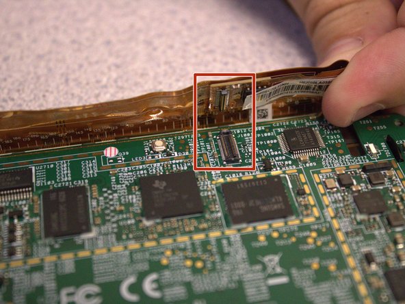

    • Disconnect the orange ribbon cable from the motherboard.
    • Using your fingers, gently lift the motherboard from the display.

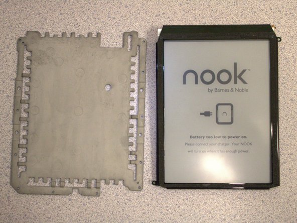

  9. Nook Simple Touch with GlowLight Screen Replacement, Screen: crwdns2935265:09crwdnd2935265:01crwdnd2935265:02crwdne2935265:0 Nook Simple Touch with GlowLight Screen Replacement, Screen: crwdns2935265:09crwdnd2935265:02crwdnd2935265:02crwdne2935265:0
    • Insert the iFixit opening tool between the display and the front case.
    • Gently move to iFixit opening tool around the perimeter to release the set of tape strips.
  10. Nook Simple Touch with GlowLight Screen Replacement: crwdns2935265:010crwdnd2935265:01crwdnd2935265:02crwdne2935265:0 Nook Simple Touch with GlowLight Screen Replacement: crwdns2935265:010crwdnd2935265:02crwdnd2935265:02crwdne2935265:0
    • Turn the display over. Pry the display bezel from the display assembly with the iFixit opening tool.
