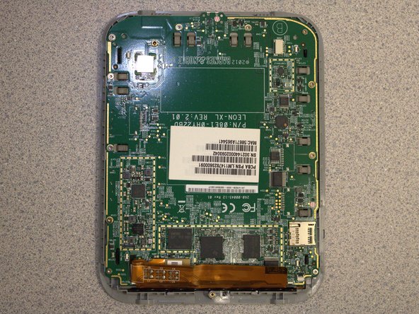

    • Place the Nook with the screen facing down.
  2. Nook Simple Touch with GlowLight Battery Replacement: crwdns2935265:02crwdnd2935265:01crwdnd2935265:01crwdne2935265:0
    • Wedge the opening tool between the power button and the upper edge of the device.
    • Push the opening tool down to pry the power button up.
  3. Nook Simple Touch with GlowLight Battery Replacement: crwdns2935265:03crwdnd2935265:01crwdnd2935265:01crwdne2935265:0
    • Using your fingers, gently remove the power button.
  4. Nook Simple Touch with GlowLight Battery Replacement, Back Cover: crwdns2935265:04crwdnd2935265:01crwdnd2935265:01crwdne2935265:0
    • Remove the single screw using a T4 Torx screwdriver.
  5. Nook Simple Touch with GlowLight Battery Replacement: crwdns2935265:05crwdnd2935265:01crwdnd2935265:01crwdne2935265:0
    • Slide the back cover down towards you in the direction of the charging port.
  6. Nook Simple Touch with GlowLight Battery Replacement, Battery: crwdns2935265:06crwdnd2935265:01crwdnd2935265:02crwdne2935265:0 Nook Simple Touch with GlowLight Battery Replacement, Battery: crwdns2935265:06crwdnd2935265:02crwdnd2935265:02crwdne2935265:0
    • Detach the white cable connector from the motherboard.
    • Remove the battery from the device.
