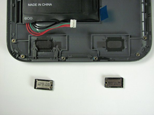

  5. Nook HD Speakers Replacement, Speakers: crwdns2935265:05crwdnd2935265:01crwdnd2935265:02crwdne2935265:0 Nook HD Speakers Replacement, Speakers: crwdns2935265:05crwdnd2935265:02crwdnd2935265:02crwdne2935265:0
    • Use the plastic opening tool to pry the speakers away from the back plate starting with the inside edge. The speakers are likely glued to the backplate so some resistance is expected.
    • Place the replacement speakers so that they line up properly with the circuit board in order to make a connection.
