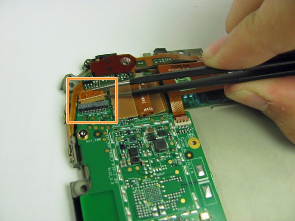

  7. Nook HD Motherboard Replacement: crwdns2935265:07crwdnd2935265:01crwdnd2935265:01crwdne2935265:0
    • The final connection is a large orange ribbon cable that connects to an entirely separate circuit board.
    • Use the plastic opening tool to gently pry the cable away from the smaller circuit board as to disconnect the cable from the pins.
    • Carefully pull the ribbon cable out of the plastic connection housing.

what is the name of the connector in step 7?
