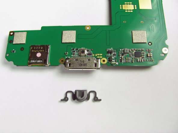

    • Use the T5 torx screwdriver to remove the four 2.5 millimeter screws that attach the motherboard to the back plate.
  9. Nook HD Button Replacement: crwdns2935265:09crwdnd2935265:01crwdnd2935265:01crwdne2935265:0
    • Gently pull the motherboard straight off of the back plate.
  10. Nook HD Button Replacement, Button: crwdns2935265:010crwdnd2935265:01crwdnd2935265:02crwdne2935265:0 Nook HD Button Replacement, Button: crwdns2935265:010crwdnd2935265:02crwdnd2935265:02crwdne2935265:0
    • Using the plastic opening tool, lever the button arms towards the center of the nook so the button mechanism slides free.
    • Check moving parts for dust or other obstructions and contacts for insulators.
