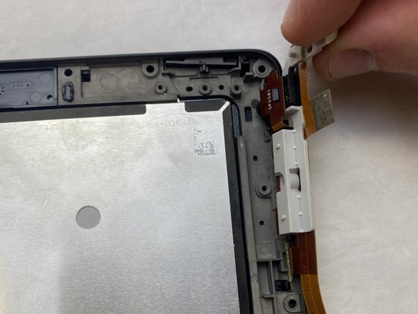

      • Open the plastic frame by wedging the plastic iFixit opening tool under the plastic frame to remove adhesive.
      • Pop up all plastic tabs that secure the frame to the chassis.
    2. Nook HD+ Volume/Power Buttons Replacement: crwdns2935265:02crwdnd2935265:01crwdnd2935265:03crwdne2935265:0 Nook HD+ Volume/Power Buttons Replacement: crwdns2935265:02crwdnd2935265:02crwdnd2935265:03crwdne2935265:0 Nook HD+ Volume/Power Buttons Replacement: crwdns2935265:02crwdnd2935265:03crwdnd2935265:03crwdne2935265:0
      • Remove twenty 5.0 mm Torx T5 screws that hold the chassis to the back casing.
      • Disconnect battery from motherboard.
      • Remove back casing.
    3. Nook HD+ Volume/Power Buttons Replacement: crwdns2935265:03crwdnd2935265:01crwdnd2935265:02crwdne2935265:0 Nook HD+ Volume/Power Buttons Replacement: crwdns2935265:03crwdnd2935265:02crwdnd2935265:02crwdne2935265:0
      • Disconnect both ribbons from the motherboard by pulling up on the dark grey flaps and pulling out the ribbons.
      • Use tweezers to lift the flaps.
    4. Nook HD+ Volume/Power Buttons Replacement: crwdns2935265:04crwdnd2935265:01crwdnd2935265:02crwdne2935265:0 Nook HD+ Volume/Power Buttons Replacement: crwdns2935265:04crwdnd2935265:02crwdnd2935265:02crwdne2935265:0
      • Remove three 5.0 mm Torx T5 screws that secure buttons to chassis.
      • Slide button assembly up and out of the chassis.
