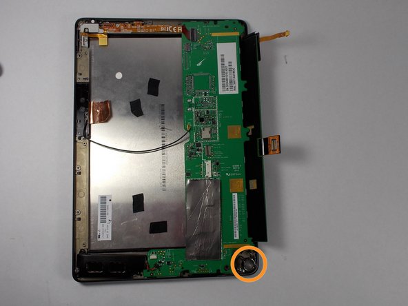

  1. Nook HD+ Speaker Replacement, Take off the Top Frame: crwdns2935265:01crwdnd2935265:01crwdnd2935265:01crwdne2935265:0
    • Wedge the plastic opening piece underneath the bottom left hand corner of the front frame
    • Pry open the front frame.
  2. Nook HD+ Speaker Replacement, Remove the screws: crwdns2935265:02crwdnd2935265:01crwdnd2935265:02crwdne2935265:0 Nook HD+ Speaker Replacement, Remove the screws: crwdns2935265:02crwdnd2935265:02crwdnd2935265:02crwdne2935265:0
    • Remove every visible screw tying the chassis to the bottom frame using a T-4 screwdriver bit.
  3. Nook HD+ Speaker Replacement, Remove the Battery: crwdns2935265:03crwdnd2935265:01crwdnd2935265:02crwdne2935265:0 Nook HD+ Speaker Replacement, Remove the Battery: crwdns2935265:03crwdnd2935265:02crwdnd2935265:02crwdne2935265:0
    • Carefully remove the bottom frame from center chassis.
    • Detach the battery ribbon from the motherboard.
    • Flip the center chaise onto the screen side with the hole positioned on the bottom right hand corner.
  4. Nook HD+ Speaker Replacement, Unscrew the speaker: crwdns2935265:04crwdnd2935265:01crwdnd2935265:01crwdne2935265:0
    • In the bottom left hand corner remove the 3 screws that at attached to the speaker
    • Disconnect the small red and black ribbon connected to the speaker from the white clip on the mother board.
    • Replace old speaker with new speaker then follow instructions in reverse order to reassemble

After purchasing a replacement speaker, these steps worked well. Process to a fairly relaxed 20 minutes.
The only thing I’d add is that the speaker is part # AAC121217U22A, and appears to be a bespoke part containing two speakers.
Knowing what part to look for may help others looking for a replacement part.
