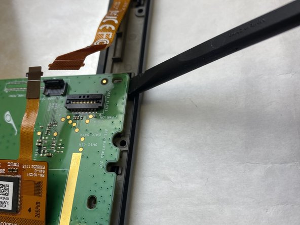

    • Open the plastic frame by wedging the plastic iFixit opening tool under the plastic frame to remove adhesive.
    • Pop up all plastic tabs that secure the frame to the chassis.

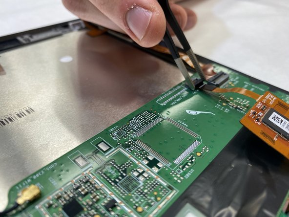

    • Disconnect both ribbons from the motherboard by pulling up on the dark grey flaps and pulling out the ribbons.
    • Use tweezers to lift the flaps.

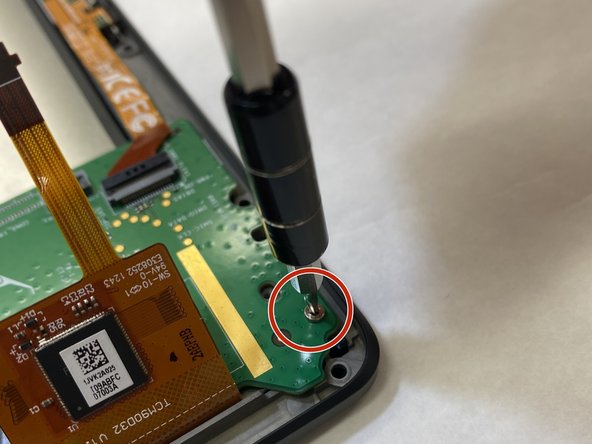

    • Remove two 5.0 mm Torx T5 screws attached to the motherboard using a screwdriver.
    • Lift the small foam piece attached to the black strip on the motherboard and gently pull up.
