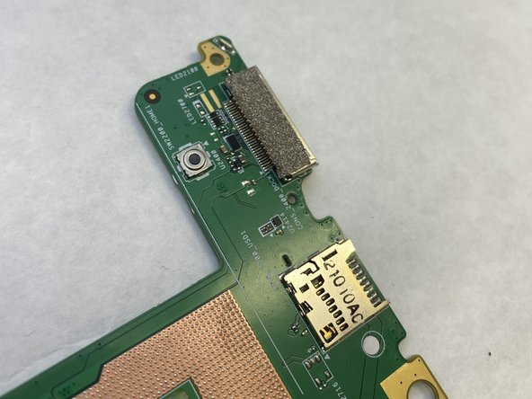

  8. Nook HD+ Charging Port Replacement, Charging Port: crwdns2935265:08crwdnd2935265:01crwdnd2935265:02crwdne2935265:0 Nook HD+ Charging Port Replacement, Charging Port: crwdns2935265:08crwdnd2935265:02crwdnd2935265:02crwdne2935265:0
    • Once removing the motherboard, flip it over and locate the charging port. Use a soldering iron to disconnect the charging port from the motherboard. If confused here's a reference.
    • Since the charging port is attached to the motherboard, it is simpler to replace both.
    • Soldering iron will be very hot and can both burn your hand and possibly damage the device.
    • Solder the new charging port to the motherboard.
