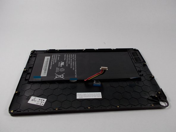

  5. Nook HD+ Battery Replacement, Remove the battery: crwdns2935265:05crwdnd2935265:01crwdnd2935265:02crwdne2935265:0 Nook HD+ Battery Replacement, Remove the battery: crwdns2935265:05crwdnd2935265:02crwdnd2935265:02crwdne2935265:0
    • Pry battery off of bottom frame using plastic opening tool.
  6. Nook HD+ Battery Replacement, Place new battery: crwdns2935265:06crwdnd2935265:01crwdnd2935265:01crwdne2935265:0
    • Apply glue to the bottom side of new battery. Re-insert new battery onto bottom frame and allow to dry. Follow steps in reverse to put nook back together.
