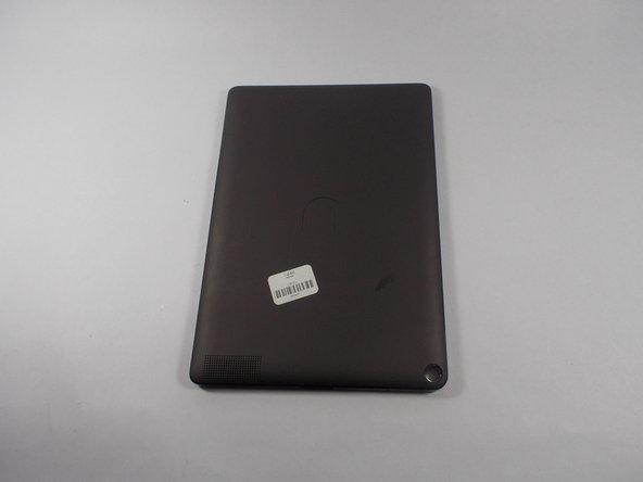

    • Pry the front frame off of the nook by wedging the plastic opening piece between the frame and the nook.
  2. Nook HD+ Antenna Replacement, Remove the screws: crwdns2935265:02crwdnd2935265:01crwdnd2935265:02crwdne2935265:0 Nook HD+ Antenna Replacement, Remove the screws: crwdns2935265:02crwdnd2935265:02crwdnd2935265:02crwdne2935265:0
    • Remove every visible screw from the front of the nook using the T-4 attachment for the screwdriver in the iFixit screwdriver kit.

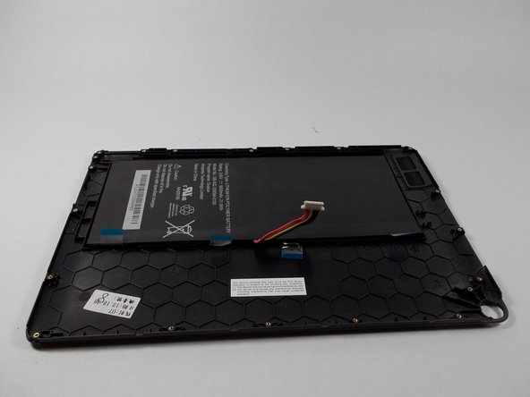

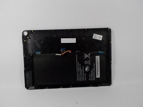

    • Carefully remove the center chassis from the bottom frame.
  4. Nook HD+ Antenna Replacement, Dettatch battery: crwdns2935265:04crwdnd2935265:01crwdnd2935265:03crwdne2935265:0 Nook HD+ Antenna Replacement, Dettatch battery: crwdns2935265:04crwdnd2935265:02crwdnd2935265:03crwdne2935265:0 Nook HD+ Antenna Replacement, Dettatch battery: crwdns2935265:04crwdnd2935265:03crwdnd2935265:03crwdne2935265:0
    • Detach the battery ribbon from the motherboard.

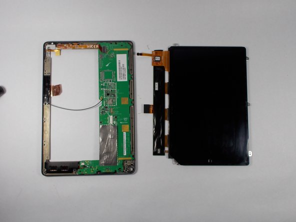

  5. Nook HD+ Antenna Replacement, Flip the center chassis: crwdns2935265:05crwdnd2935265:01crwdnd2935265:01crwdne2935265:0
    • Flip the center chassis so that the screen is facing down, and the hole is positioned in the bottom right corner.

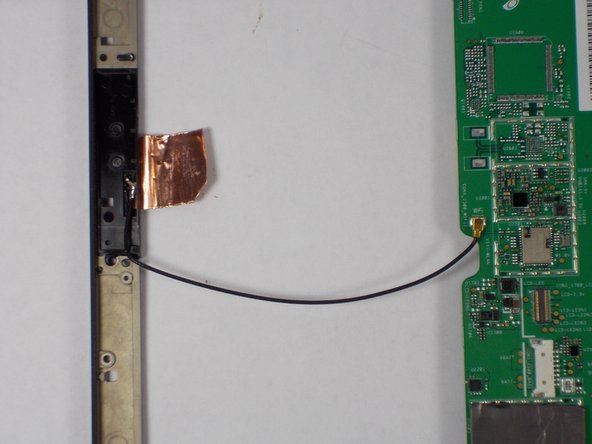

  6. Nook HD+ Antenna Replacement, Remove the antenna part 1: crwdns2935265:06crwdnd2935265:01crwdnd2935265:02crwdne2935265:0 Nook HD+ Antenna Replacement, Remove the antenna part 1: crwdns2935265:06crwdnd2935265:02crwdnd2935265:02crwdne2935265:0
    • Remove the wire from the attachment on the motherboard (this wire un-clips).
  7. Nook HD+ Antenna Replacement, Remove the antenna part 2: crwdns2935265:07crwdnd2935265:01crwdnd2935265:02crwdne2935265:0 Nook HD+ Antenna Replacement, Remove the antenna part 2: crwdns2935265:07crwdnd2935265:02crwdnd2935265:02crwdne2935265:0
    • Apply soldering iron to the wire where it connects on the frame side. Remove wire when the solder is molten.
  8. Nook HD+ Antenna Replacement, Place new antenna.: crwdns2935265:08crwdnd2935265:01crwdnd2935265:02crwdne2935265:0 Nook HD+ Antenna Replacement, Place new antenna.: crwdns2935265:08crwdnd2935265:02crwdnd2935265:02crwdne2935265:0
    • Replace new antenna following all the steps in reverse.
