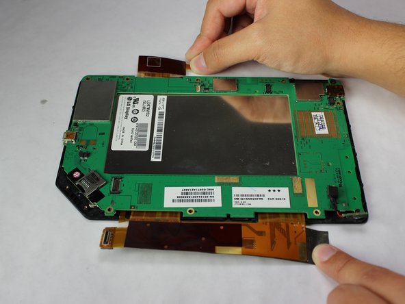

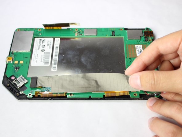

    • Gently lift and peel the orange and grey ribbon connectors to disconnect the screen and motherboard.
  7. Nook Color Motherboard Replacement: crwdns2935265:07crwdnd2935265:01crwdnd2935265:01crwdne2935265:0

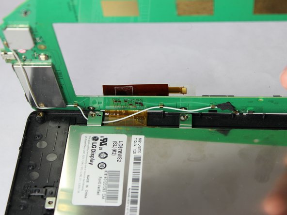

    • Remove the easy-to-miss T5 Torx 3.8 mm screw located in the tabbed corner of the device.
  8. Nook Color Motherboard Replacement: crwdns2935265:08crwdnd2935265:01crwdnd2935265:02crwdne2935265:0 Nook Color Motherboard Replacement: crwdns2935265:08crwdnd2935265:02crwdnd2935265:02crwdne2935265:0
    • Lift the motherboard gently from the side with the larger connector ribbon.
    • Slide the white cable gently from underneath its holding place to free the motherboard completely.
    • Remove the motherboard carefully from the device.
