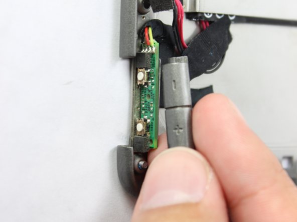

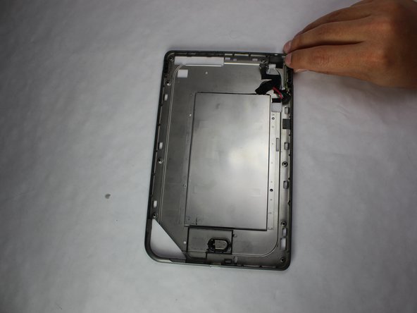

    1. Nook Color Buttons Replacement, Buttons: crwdns2935265:06crwdnd2935265:01crwdnd2935265:03crwdne2935265:0 Nook Color Buttons Replacement, Buttons: crwdns2935265:06crwdnd2935265:02crwdnd2935265:03crwdne2935265:0 Nook Color Buttons Replacement, Buttons: crwdns2935265:06crwdnd2935265:03crwdnd2935265:03crwdne2935265:0
      • Once you have removed both the back and front panels of the device, you will isolate the panel which contains the buttons. You will remove the volume buttons on the top right first. Use some force upwards and the button will slide free.

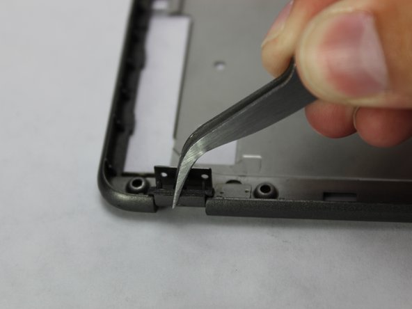

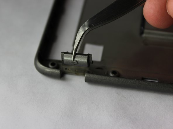

    2. Nook Color Buttons Replacement: crwdns2935265:07crwdnd2935265:01crwdnd2935265:03crwdne2935265:0 Nook Color Buttons Replacement: crwdns2935265:07crwdnd2935265:02crwdnd2935265:03crwdne2935265:0 Nook Color Buttons Replacement: crwdns2935265:07crwdnd2935265:03crwdnd2935265:03crwdne2935265:0
      • Next, you will remove the power button from the top left of the middle portion of your device. Using tweezers you will carefully lift the button from where it sits and remove it.
