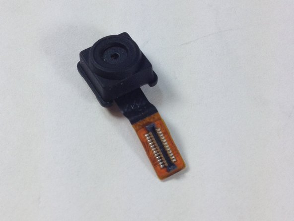

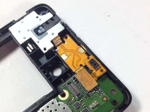

    1. Nokia X Rear-Facing Camera Replacement, Remove Camera: crwdns2935265:07crwdnd2935265:01crwdnd2935265:03crwdne2935265:0 Nokia X Rear-Facing Camera Replacement, Remove Camera: crwdns2935265:07crwdnd2935265:02crwdnd2935265:03crwdne2935265:0 Nokia X Rear-Facing Camera Replacement, Remove Camera: crwdns2935265:07crwdnd2935265:03crwdnd2935265:03crwdne2935265:0
      • Use a spudger to disconnect the rear-facing camera ribbon cable connector from the motherboard.
      • Remove the camera module by merely picking it up out of its housing slot.
